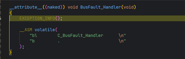

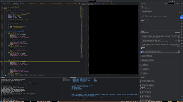

Analysing the exact moment of the crash:
  • crash happens (presumably) after MCUBOOT on pinctrl_nrf.c at "pinctrl_configure_pins" function, specifically, this line "NRF_PSEL_SPIM(reg, SCK) = psel;"
  • it is caused by setting the SCK pin (at the time we used pin 22)
  • I made the breakpoint conditional (for the function) when the reg parameter is (0x40009000) which is for SPI1.
    • This made it possible to step into the code (without it, the debugger would crash as soon as you step into it)
    • reg is 0x40009000 which is indeed for SPI1 (or any "1" peripherial)
    • the pin count is 3 (mosi, miso, sck) as we expect
    • the *pins is 0x5623c or "0101 0110 0010 0011 1100" in binary
  • Stepping into that line goes to the fault we expect.
  • This happens in the first loop iterarion on the SCK pin (22)
  • As soon as you go into that macro, we get this:
  • debugger on the moment of the crash
Are we doing something seriously wrong or it is not possible to use all 4 peripherals at once?
