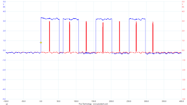

NRF5340DK High frequency SPIM communication failure / spi_transceive() delay problem
I am trying to exchange data with an external slave sensor via SPIM communication using the nRF5340DK.
I am currently facing two main issues:
1.The spi_transceive() function takes too long to execute.
This is significantly reducing the effective data transfer rate.
I have also reviewed a Q&A from someone who pointed out a similar delay with spi_transceive().
( Time gap between each spi_transceive )
However, the solution suggested in that Q&A, which involved modifying spi configuration in the main.c, doesn't seem to be applicable to the nRF5340 as it resulted in an error
To clearly explain my situation, I have attached my main.c, overlay, and configuration files.

In main.c, when I configure the SPI structure, I set the frequency to 1MHz.
I have confirmed with an oscilloscope that the actual clock frequency is indeed 1MHz.
Also, I'm controlling the CS pin directly via GPIO
2. Although the nRF5340 specifications state that it supports SPI frequencies up to 8MHz (and even up to 32MHz for spi4),
the quality of the Clock (CLK) signal degrades significantly at frequencies higher than 4MHz.
Thank you.

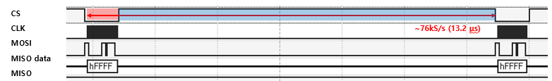

  • Thank you very much for taking the time to help me.
    My plan was as follows:
    1.Before using DPPI as you advised, I first wanted to try using the nrfx_spim_xfer() function directly, which appears to be for direct SPI driver access, rather than the spi_transceive() function that seems to be used with the Zephyr RTOS.
    2.After that, I intended to move on to the code using GPPI.
    1. Results from using nrfx_spim_xfer()

  • Dear Elfving,
    Hello. It took some time to optimize the code, as there were a few issues.
    Currently, by linking the TIMER and SPI modules via GPPI, I have achieved much faster SPI communication compared to the blocking mode based on Zephyr RTOS and nrfx drivers.
    (SPI communication rate: 76kS/s to 355kS/s)
