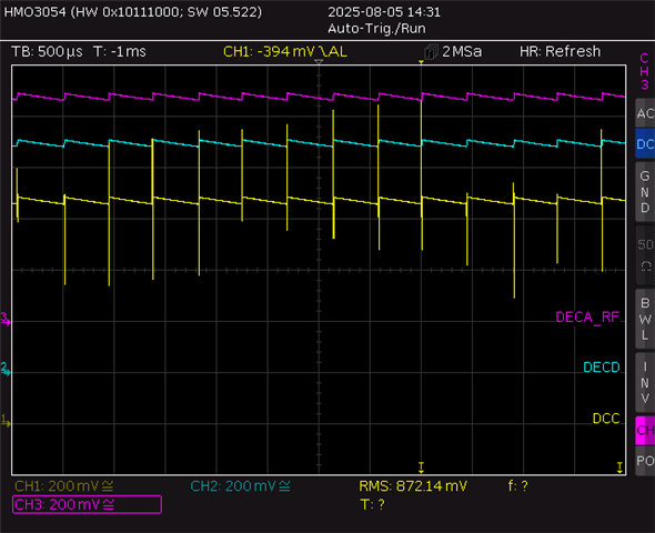

I am evaluating the nRF54L15 for potential use in a new product. I did some measurements of the average current consumption and the vaues were a bit higher than i was expecting. Among other things i checked also the status of the DCDC converter. It is enabled in the Software (VREGMAIN.DCDCEN = 1) and the necessary external components are also present on our custom board. I also checked the inductor and it appears to be OK. But the Inductor detected status shows an inductor failure (VREGMAIN.INDUCTORDET = 0).
I did a measurement of the voltages at DCC, DECD and DECA_RF pins, and it looks like the DCDC converter is running:
So my question is: how do i interpret the VREGMAIN.INDUCTORDET register correctly? Am i doing something wrong here?
