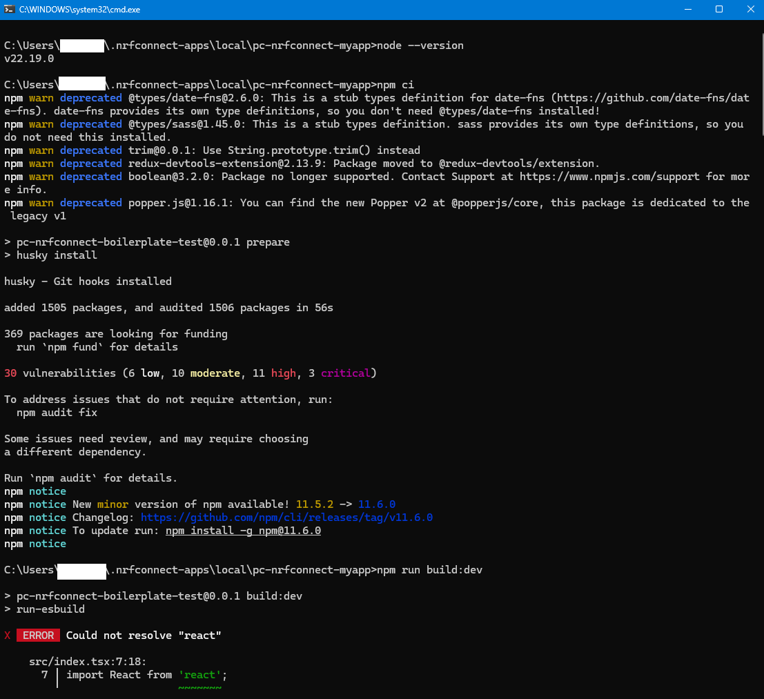

npm run build:dev always failed after npm ci with the error “Could not resolve ‘react’”.It appears that the project cannot be built when it resides in
~/.nrfconnect-apps/local, at least on my system (Windows 11 + Node.js v24.5.0).

Hi Elfving, I just tried under Node.js v22.19.0, however the same issue, see below screenshot:

Is the react module installed in node_modules\react after running npm ci? Does npm ls react show it?

Yes, react folders are under folder node_modules, and npm ls react shows:
C:\Users\myname\.nrfconnect-apps\local\pc-nrfconnect-myapp>npm ls react
[email protected] C:\Users\myname\.nrfconnect-apps\local\pc-nrfconnect-myapp
+-- @nordicsemiconductor/[email protected]
