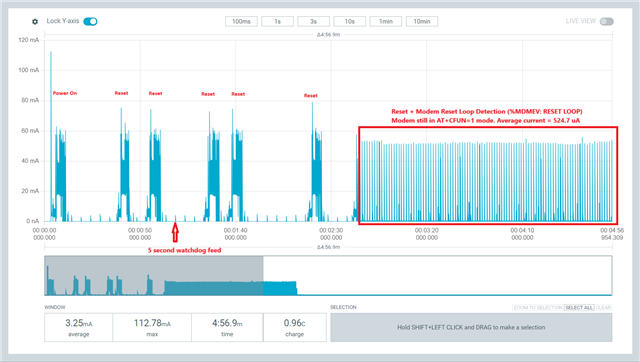

  • Hey Øyvind,
    I took some current measurements using a PPK2 while the modem reset loop detection mechanism was active and the modem was in AT+CFUN=1 mode. You can see from the screenshot below that each large spike of current is from me pushing the reset button on the nRF9151DK and the modem registering on the network. The small spikes are my 5 second watchdog feed, so ignore those. You can see the module enter PSM after every reset until the modem reset loop detection kicks in. At this point, the module has a large current spike every 1.28 seconds for what appears to be the entirety of the 30 minutes (I let it run for 11 minutes before stopping my capture).
    Averaging this current over ~3 minutes shows an average of 524.7 uA.
    My PSM floor current (Including the 5 second watchdog feed) is ~3.0 uA.
    524.7 uA is significant compared to 3.0 uA for an ultra-low power module that is blocked from network activity. The module appears to be in +CEREG: 2 (searching) mode during this lockout period.
    Ideally, the module should stop searching during this period. It would be great if I could put the module in airplane mode, proprietary PSM, or some ultra-low power mode during the 30-minute modem reset loop detection lockout period. Is this not possible?
    Also, I tested switching from AT+CFUN=1 and AT+CFUN=4 10 times back to back and this did not trigger the modem reset loop detection as expected.
    Derek
  • Hi Derek,
    First of all, yes, you can wait for the restriction to be over in CFUN=4 state as long as there is no power cut.
    Question: Is putting the module in flight mode (AT+CFUN=4) another way to gracefully de-register from the network that will not trigger the reset loop restriction?
    Yes.
    Basically, the reset loop restriction is a consequence of something going really wrong and for multiple times, so the requirement was just to prevent signaling. No focus on power consumption as your device should not end in a reset loop restriction.
    Øyvind
