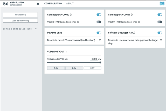

CS PIN WHEN SET HIGH IS 1.8V, and I need at least 2.8V
So when I toggle the pin high, it gets set to 1.8V. I want it to be at least 2.8V. I did configure the VDD to 3.3V. The VDDIO does show 3.3V, but a pin like let say P1.11 set to high will only be 1.8V. So I want it to drive an eink display but it doesn't recognize the pin going high because the nrf54l15 pin only goes high to 1.8V and needs at least 2.8V for it to be considered High for the eink display controller. So is this a board problem, or there is no functionality to fix this? Would I just need a level-shifter? Also, I'm using a nrf54l15 dk. PCA10156. 0.9.3 2025.26 1057705559
    Have you measured the VDD/VDDM voltage of the nRF54L15DK? The GPIO high voltage is equal to the VDD/VDDM voltage.
    When using the board configuration the config needs to be written to the board, before the VDD voltage is changed.
    To verify that the config has been changed I recommend reconnecting the USB debug connector after writing the config and relaunching the board configuration. The currently used config will be loaded form the board after a couple of seconds.
    Bendik
  • I did measured the VDD/VDDM voltage of the nRF54L15DK and it is getting 3.3V. The VDDIO is also getting 3.3V. However, I'm still not getting the GPIO high voltage being equal to the VDD/VDDM voltage. I'm still getting 1.8V.

  • The e-ink display must have a supply above 2.8V to stop internal schottky protection diodes clamping at a lower voltage and if an interface chip is used on the e-ink display that interface must also have a supply above 2.8V unless it is a level-shifter interface. Worth measuring the e-ink supply voltage to be sure, ideally same voltage as NRF54.
    If e-ink voltage is correct try setting the pin to be High-Drive (not an option for all io pins).
    On the DK I think P1.11 is also used as a TWI SCL which needs to be disabled or disconnected.
  • Thanks. So when I turn on DRIVE 1 HIGH in the device tree visual editor it reaches 2.9V, so that worked.
