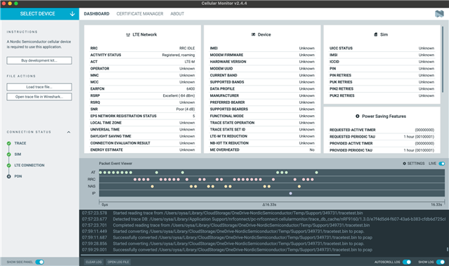

    4. Convert the Trace to PCAP Format (Optional)
      You can convert the captured .bin file to PCAP format for analysis in Wireshark using the Cellular Monitor app or nrfutil:
      nrfutil trace lte --input-file modem_trace.bin --output-pcapng rtt-trace.pcapng
      Asset Tracker Template: Modem Tracing
    5. View the Trace
      • Open the .bin or .pcapng file in the Cellular Monitor app or Wireshark for analysis.
      • Note: In the current release, Cellular Monitor does not support live RTT capture, but you can load and view previously captured RTT traces Viewing RTT traces in Cellular Monitor.
