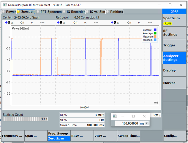

    At the end I am looking for a basic Bluetooth LE example in the new SDK V3.0.2 from where I can set up the Advertising Interval and the transmit power. I don't need any other features. In the old SDK, I was using the ble_app_proximity example as it was very easy in the Segger IDE to change the Advertising Interval and the Transmit power.
    I am just using my Nordic dev kit nRF52840 and nRF5340 to do some RF PHY testing with my R&S CMW and CMP testers.

    I was able to modify the preipheral_uart example and set the Advertising Interval parameters to 20 ms .. 40 ms.
    I can see the DUT Averstising between 20 to 30 ms on the PHY layer which is great.
    I was also able to change the power adding the directive CONFIG_BT_CTLR_TX_PWR_PLUS_4=y in the prj.conf file.
