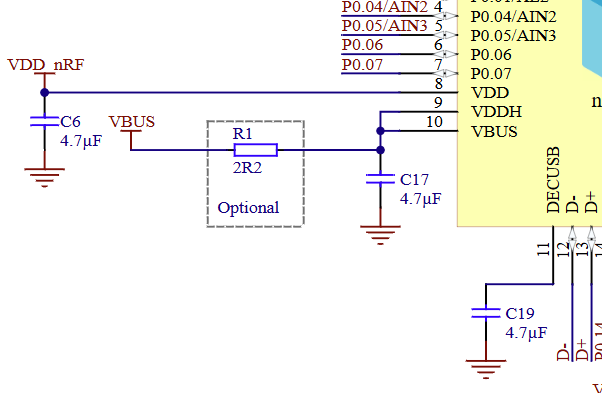

I'm hoping to use the nRF52820 (QFN package) powered by a USB connection (not with external battery).

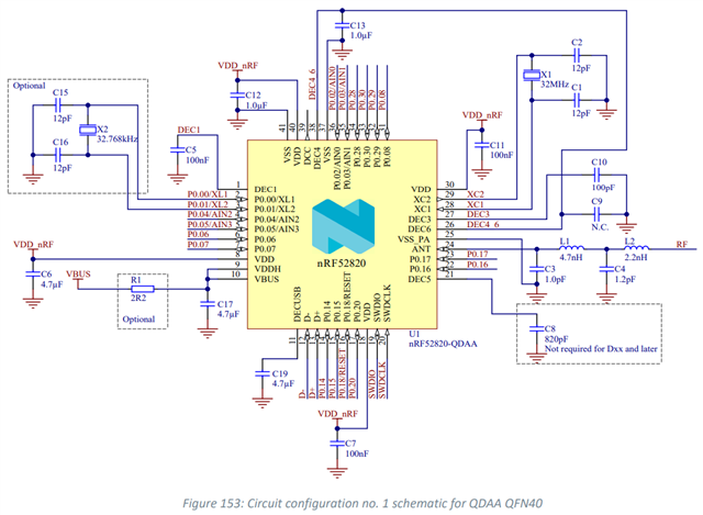

I'm referring to Figure 153 of the datasheet, which shows Circuit Configuration #1 and is the only reference design available showing a USB-powered connection:
From the notes above in Section 7.3 Reference Circuitry, it seems that when supplying power through USB, VBUS and VDDH must be connected:
My questions are:

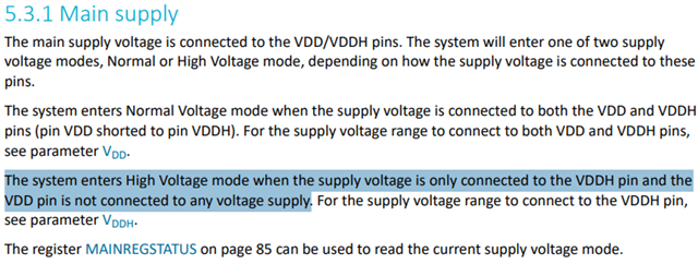

(1) When powering the nRF52820 using USB, it is only possible to use High Voltage mode (Normal Voltage mode is not possible), correct?  As shown in Section 5.3.1 Main Supply?
(2) In High Voltage mode, since VDD is internally generated, would this be the voltage rail that SPI and other logic signals pull-up to?
(3) Similarly, when using an external J-Link to flash the nRF52820, the power pin of the J-Link would connect to the internally generated VDD rail?

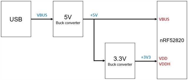

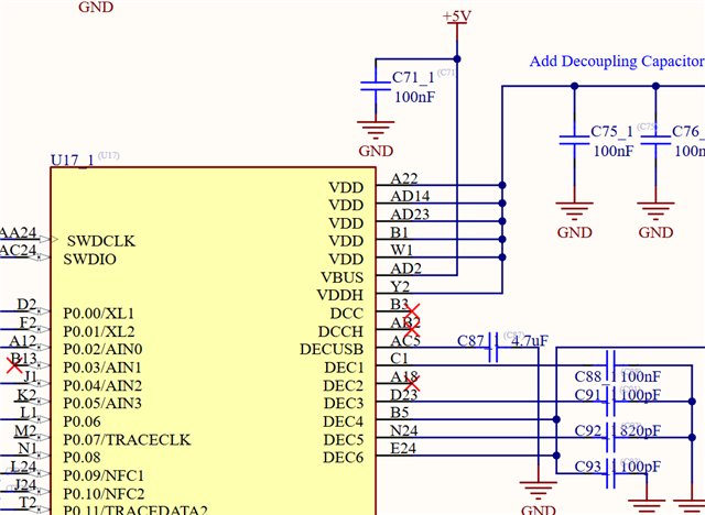

(4) Would a configuration like this be possible where VDD and VDDH are connected and supplied externally, while only VBUS is connected to +5V?  If not, why not?  FYI, the diagram below uses nRF52840 but the idea would be the same for nRF52820

    You can add DCDC components if you want, so we dont show all possible combinations, but for the USB section this is correct.
    Correct, VDDH needs to be used here. The alterative here is to have a external regulator that steps down the voltage that you could then use to supply the device in normal voltage mode. So something like the figure 2 https://docs.nordicsemi.com/bundle/ps_nrf52820/page/ref_circuitry.html#ariaid-title3 is also an option.

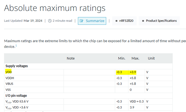

    It is not possible to power the nRF52 in normal voltage mode directly from the USB as the voltage is to high. https://docs.nordicsemi.com/bundle/ps_nrf52820/page/abs_max_ratings.html
    Correct.
    You can use an external regulator to step down the voltage so that the nRF can work in normal voltage mode.

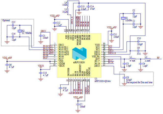

  • Sorry for the late reply here:
    sunghoryu said:
    (1) So Figure 2 shows VDDH being connected to VDD instead of VBUS. Would this be the Normal Voltage mode?
    Yes, this is normal voltage mode.
    sunghoryu said:
    Assuming VBUS is connected to +5V of the USB, would VDD_nRF be externally supplied i.e. +3V3 buck converter? Would this be a safe mode of operation for the nRF52820?
    You can choose to either supply the nRF from normal voltage mode or High voltage mode, both options also support the use of USB but the implementation can be a bit different.
    If you intend to only power the device from USB as it seems that you are doing then the simplest solution to implement is to configure the device for High voltage mode and use the USB as  a source.

    sunghoryu said:
    Would a configuration like below be acceptable to power the nRF52820 and also use the USB connection (assuming D+/- connection)?
    Yes you can also set up the device to be powered in this way, normal voltage mode and then power the VBUS separately for USB use case, but you will need extra converter to step down the voltage for normal voltage mode config.
