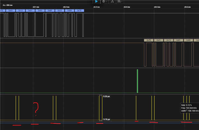

I've did some tests and decreased RX_TIMEOUT_DIV and tested with different timeouts. Basically, timeouts with higher values are working properly (3000us, 300us), but when I come close to ~60us it stops having periodicity

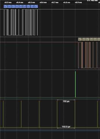

Good case with 300us and divider = 2 - timeout happens every 150us (yellow spikes)
Bad case 80us, divider = 2 (yellows spikes are from rx_timeout handler, not periodic at all)
