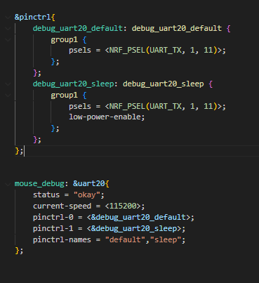

I want to use the UART20 serial port to map to other pins for easier PCB layout, but when I use the NRF54L15,
overlay config
debug_uart20_default: debug_uart20_default {
        group1 {
            psels = <NRF_PSEL(UART_TX, 1, 5)>;
	debug_uart20_sleep: debug_uart20_sleep {
        group1 {
			low-power-enable;
mouse_debug:&uart20 {
    status = "okay";
    current-speed = <9600>;
    pinctrl-0 = <&debug_uart20_default>;
    pinctrl-1 = <&debug_uart20_sleep>;
    pinctrl-names = "default","sleep";
my main code
 bsp_board_init();
    while (1)
        drv_sensor_init();
        dsadsa = bsp_adc_get_value(ADC_CHANNEL_0);
        printk("volatage : %d mv\n", dsadsa);
        k_msleep(1000);
but  no printk  or printf
What should I do ?

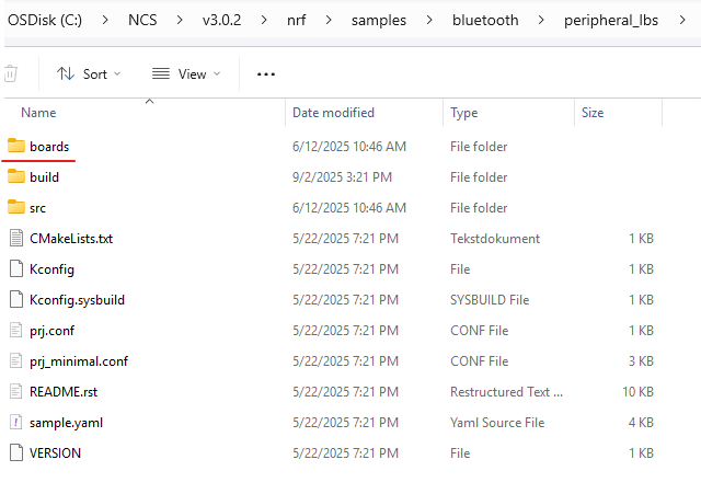

  • nrf54l15dk_nrf54l15_cpuapp.overlay   ?
    Will the overlay built directly in the future be placed in the boards folder according to the boards we configured? Assuming I am currently in NS
    nrf54l15dk_nrf54l15_cpuapp_ns.overlay?
  • No, the build folder will as usual be placed in your project folder itself, but the overlays need to be placed in a separate "boards" file in your project folder. Similar to this:
    Yes that's right.
    -Priyanka

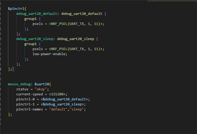

  • Hello, I have encountered a very strange problem now. My initialization has blocked all my code, only Printk but no printing. Is it possible that there is a problem with my project?? This is my overlay
    // 根目录
     	zephyr,user {
    	// ADC 通道
    	// io-channels 			= <&adc 1>;
    	// 鼠标按键 : 	左 		右 		中 		FB(前进) 	BB(后退)
    	mouse_key_left-gpios 		= <&gpio1 13 ( GPIO_ACTIVE_LOW )>;
    	mouse_key_right-gpios 		= <&gpio1 9  ( GPIO_ACTIVE_LOW )>;
    	mouse_key_center-gpios 		= <&gpio1 8  ( GPIO_ACTIVE_LOW )>;
    	mouse_key_fb-gpios 			= <&gpio0 4  ( GPIO_ACTIVE_LOW )>;
    	// // mouse_key_bb-gpios 	= <&gpio1 13 GPIO_ACTIVE_HIGH>;
    	// // mouse_test_led-gpios 		= <&gpio2 9 GPIO_ACTIVE_HIGH >;
    	board_led0-gpios = <&gpio2 9  	GPIO_ACTIVE_HIGH>;
    	board_led1-gpios = <&gpio1 10  	GPIO_ACTIVE_HIGH>;
    	board_led2-gpios = <&gpio2 7  	GPIO_ACTIVE_HIGH>;
    	board_led3-gpios = <&gpio1 14  	GPIO_ACTIVE_HIGH>;
    	// 编码器
    	encoder_one_ea-gpios 		= <&gpio1 5 ( GPIO_ACTIVE_LOW )>;
    	encoder_one_eb-gpios 		= <&gpio1 6  ( GPIO_ACTIVE_LOW )>;
    	// 拨码开关 三段
    	// mode_switch_24g-gpios = <&gpio1 13 GPIO_ACTIVE_LOW>;
    	// mode_switch_ble-gpios = <&gpio1 13 GPIO_ACTIVE_LOW>;
    	// mode_usb_gpios 	  	  = <&gpio1 13 GPIO_ACTIVE_LOW>;
    &pinctrl {
    	// SPI30
    	paw3950_spi30_default: paw3950_spi30_default{
    		group1{
    			psels = <NRF_PSEL(SPIM_SCK,0,3)>,
    			<NRF_PSEL(SPIM_MISO,0,1)>,
    			<NRF_PSEL(SPIM_MOSI,0,2)>;
    	paw3950_spi30_sleep:paw3950_spi30_sleep{
    		group1{
    			low-power-enable;
    	// uart
            group1 {
                psels = <NRF_PSEL(UART_TX, 1, 4)>;
            group1 {
    			low-power-enable;
    	status = "okay";
    	current-speed = <115200>;
    // ADC
    mouse_vbat_adc:&adc{
    	#address-cells = <1>;
    	#size-cells = <0>;
    	channel@5 {
    		reg = <5>;
    		zephyr,gain = "ADC_GAIN_1";
    		zephyr,reference = "ADC_REF_INTERNAL";
    		zephyr,acquisition-time = <ADC_ACQ_TIME_DEFAULT>;
    		zephyr,input-positive = <NRF_SAADC_AIN5>; /* P1.12 */
    		zephyr,resolution = <12>;
    /** SPI 描述 */
    mouse_paw3950:&spi30 {
        status = "okay";
        pinctrl-0 = <&paw3950_spi30_default>;
        pinctrl-1 = <&paw3950_spi30_sleep>;
        cs-gpios = <&gpio0 0 (GPIO_ACTIVE_LOW | GPIO_PULL_UP)>;
        paw3950: mspi-device@0 {
            compatible = "bosch,bme280";
            reg = <0>;
            spi-max-frequency = <1000000>;
    		label = "paw3950";
    &temp {
     status = "okay";
    &power {
     status = "okay";
    // 关闭
    &button1 {
        status = "disabled";
    &button0 {
    &button2 {
    &button3 {
    &led0 {
    &led1 {
    &led2 {
    &led3 {
    // &spi00 {
    // 	status = "disable";
    // &nfct {
    &timer20 {
    // 删除
    /delete-node/ &mx25r64;
    /delete-node/ &{/pin-controller/pwm20_default/group1/};
    // /delete-node/ &{/soc/peripheral@40000000/uart@c6000/a01nyub/};
    /delete-node/ &{/pin-controller/uart20_default/group2/};
    my code
    #include <zephyr/kernel.h>
    #include "app_task.h"
    int main()
        // app_driver_init();
        // bsp_24g_init();
        while(1)
            printk("dasdsadsa");
            // k_msleep(1000);
            // k_sleep(K_MSEC(0xFFFFFFFF));
            // app_task_schedule();
