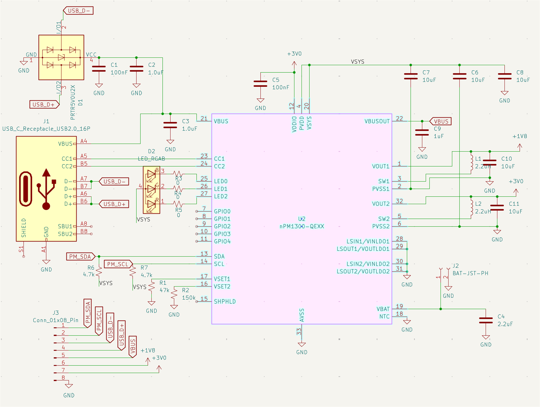

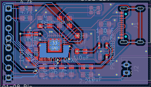

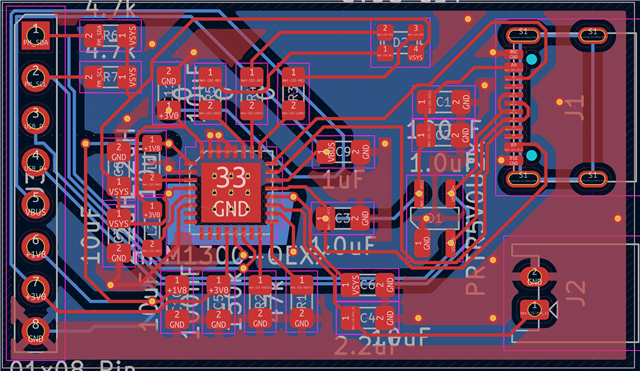

i built a small breakout board for npm1300 (QEAAD0 2516AA) to experiment with it. the twi pins are wired to the i2c ports of a raspberry pi 4 to control it, and i have attached it to a 1200mAh 3.7v lipo battery pack from adafruit (LP503562) with a 2-pin JST connector, along with a usb-c connector. here's the schematic and photo of the board (mostly just taken from the reference design):

i also notice that if i unplug the battery, the behavior is the same. the charging led stays lit, though dim, and charge status flaps between no battery detected, battery detected, and charging. my two questions:
1. is there something wrong with my circuit or configuration that's causing the ghost battery detection even when the battery is not connected?
2. similarly, is there something i need to be doing differently so that the charger doesn't rapidly flap like that when the battery is connected? ideally the led would turn off when the battery is done charging.

    after messing with everything a bit more, i did discover one potential issue (though i'm still not sure of the cause). even though i am setting the battery term voltage to 4.2, i find that if i measure the voltage on the battery terminals during this charge flapping (or even with the battery unplugged), i get 4.8v. curiously, i if i lower the term voltage setting to 3.5v, i see that it now measures around 4.3v and after a few seconds of charging, the led turns off (no error status is set). the charge status says that the battery charge is completed (this might even be correct, as i can measure 4.2v across the battery when unplugged):

    i guess +/- 10% isn't crazy but given how far off the charge voltage seems to be, i wonder if there's something wrong with my pcb design that would create these kind of issues?

    Thanks for the update. It sounds like the issue is not coming from the PMIC or the battery pack.
    I asked our HW design experts to review the PCB design, it looks like your PCB design could potentially be a major contributor to the issues you highlighted.
    Yes, the 4.8 V you are seeing on the battery terminal is definitely concerning. VOUT2 also doesn’t look correct from your measurements.
    The high-current traces are very narrow and spread across the board in a way that can cause large voltage drops and noise. In addition, there doesn’t seem to be a solid GND plane. Without a low-impedance GND reference, it’s hard to predict how current flows, and this can easily lead to level shifting/bouncing that makes comparator thresholds behave unpredictably.
    For a 2-layer board, it is critical to dedicate one layer as a solid GND plane. In your current layout this is essentially missing. If possible, I would also recommend moving to at least a 4-layer board, which will allow you to have a solid GND plane and make the routing much cleaner.
    As a reference, please take a look at:
    We strongly suggest reworking the PCB layout based on these resources.
    Once you have reworked the layout based on the guidelines, feel free to share it here before moving forward with manufacturing. We’ll be happy to review it again.
