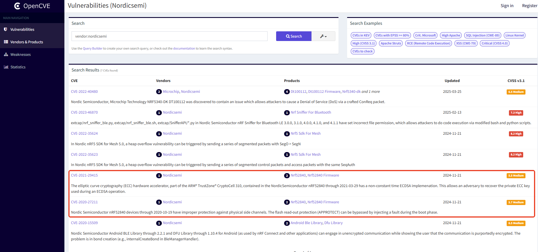

  1. Our product, BLE near-infrared device, is undergoing CRA (Cyber Resilience Act) compliance assessment—specifically for the EU RED Cybersecurity Standard.
  2. OpenCVE is a platform providing CVE data, focusing on security vulnerabilities across vendors and products.
Question:
Regarding the following two vulnerabilities, have they been resolved? If yes, is there supporting evidence?
  1. CVE-2021-29415
    The elliptic curve cryptography (ECC) hardware accelerator, part of the ARMRegistered TrustZoneRegistered CryptoCell 310, contained in the Nordic Semiconductor nRF52840 through 2021-03-29 has a non-constant time ECDSA implementation. This allows an adversary to recover the private ECC key used during an ECDSA operation.
  2. CVE-2020-27211
    Nordic Semiconductor nRF52840 devices through 2020-10-19 have improper protection against physical side channels. The flash read-out protection (APPROTECT) can be bypassed by injecting a fault during the boot phase.
    Regarding CVE-2021-29415, this is not fixed in the nRF52840 HW.  However, the risk is limited as this is mostly a theoretical attack, which may not be practical outside of a lab environment:
    • No other code can execute on the device at the same time.
    • Nordic acknowledges the weakness documented in CVE-2021-29415 about the Arm CryptoCell310 IP.
    • The nRF52840 was designed back in 2015 and physical attacks were not part of the threat model for the device.
    Regardign CVE-2020-27211, this has been fixed in revision 3 of the nRF52840. See IN141 Informational Notice v1.1.
