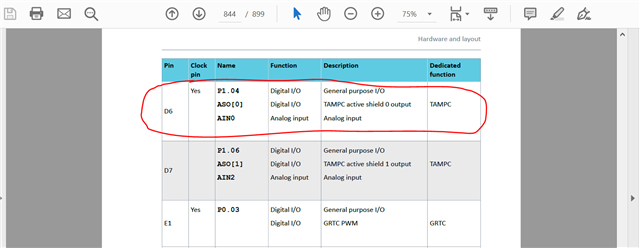

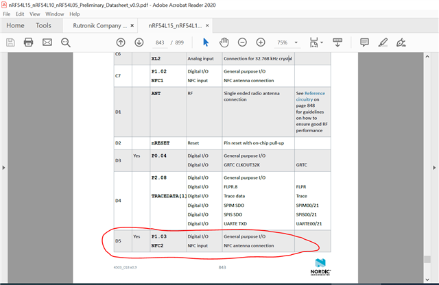

Hi Support Team
Can P1.03 and P1.04 be used for I2C or UART? The following screenshot didn't describe they can used for I2C or UART. Many thanks.

Hi Tom
Yes, you can use P1.03 and P1.04 as I2C or UART, see this for more: https://devzone.nordicsemi.com/nordic/nordic-blog/b/blog/posts/essential-pin-planning-guidelines-for-the-nrf54l-series
