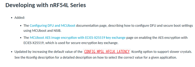

The release notes say:
Updated by increasing the default value of the CONFIG_MPSL_HFCLK_LATENCY Kconfig option to support slower crystals. See the Kconfig description for a detailed description on how to select the correct value for a given application.

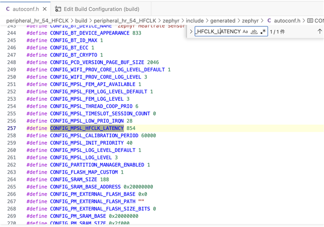

However, it seems that CONFIG_MPSL_HFCLK_LATENCY in autoconf.h remains unchanged at 854.

  • Hello Simon.
    The "config MPSL_HFCLK_LATENCY" in ncs/v3.1.0/nrf/subsys/mpsl/init/Kconfig is indeed set to 1400.
    I also ran a pristin build using toolchain 3.1.0.
    However,
    GEN_ABSOLUTE_SYM_KCONFIG(CONFIG_MPSL_HFCLK_LATENCY, 854); in build/zephyr/misc/generated/configs.c,
    #define CONFIG_MPSL_HFCLK_LATENCY 854 in autoconf.h,
    and CONFIG_MPSL_HFCLK_LATENCY=854 in .config remain at 854.
    I think it changed from 1400 to 854 somewhere, but I don't know where.
    Is there a way to find out?
    Best regards.
