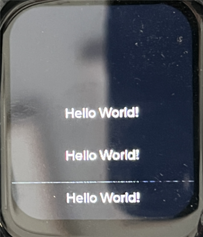

I have a custom board using a nrf5340 and a st7789 display using spi and mipi_dbi. It's I have it working on a sample project and printing "Hello World" I was using nrfConnect (Nordic’s VS Code Addin) 2.9.1 which used lvgl 8.*. When I moved the code (which is really simple) to 3.0.1 which is lvgl 9.3.0 and the screen shows “Hello World” three times starting in the center (where I expect it to be) and then twice below it.

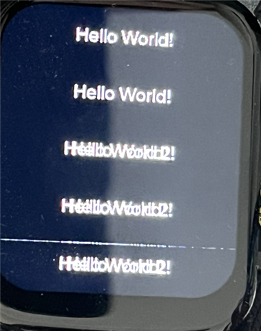

    Here is all the code. Again, this worked in 2.9.1:

    I changed it and added a "Hello World 2" screen. At first my screen looked like this:
    With the change it looked like this:
