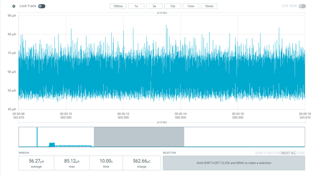

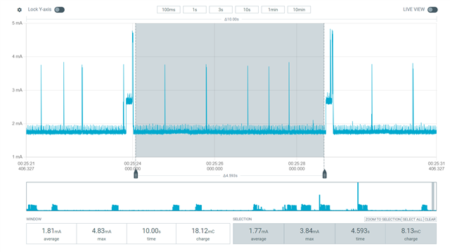

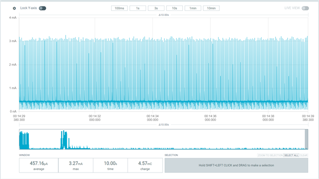

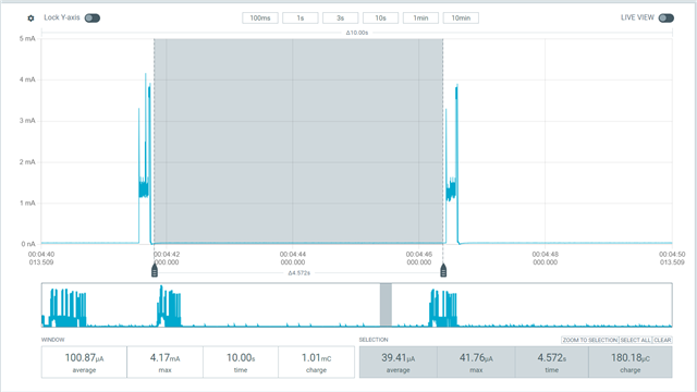

I run a couple test with the PPK2 on our board to measure and optimize the power consumption, but I had some weird results and I'm hopping you can help me out to understand the behavior. Our custom board is a BC40C module from Fanstel (nRF5340 with the DC/DC and crystals components), and a WM02C From Fanstel (nRF7002), with a flash memory and an IMU.
So to sum things up, I have a debut build with uart0 and logs enabled, and a production build with uart0 and log disabled, plus that overlay:

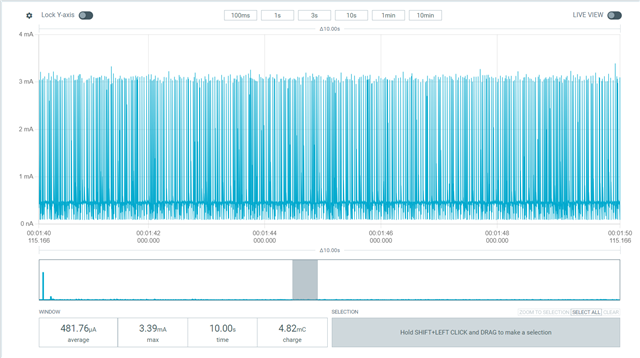

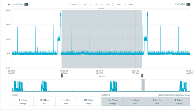

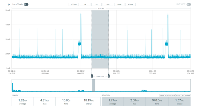

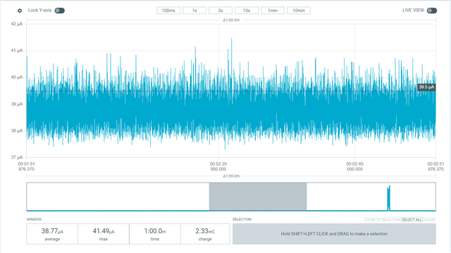

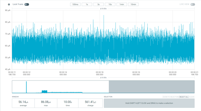

However, I have a lower power consumption wih the debug build then with the prod build. Furthermore, when I put the device into power off (with sys_poweroff()), I have a quite high power consumption too, see images below.
Debug build
Prod build
System Off (prod build)
I followed the recommandation in the documentations and the blog post here, but I still have those results, and I'm currently running out of ideas...
Any solutions? I'm joining the dts and .config files from each build here if you want to take a look, but they are pretty much the same except the differences for the logs.

  • I would start by investigating the system OFF current.
    This shouldn't really be possible. Is the supply rail you are measuring on here only going to the nRF5340, or does it also include the flash memory and IMU?
    Possible check if you may be sourcing some current through pins also.

  • Hi Kenneth,
    The measurement include the whole board, so nRF5340, nRf7002, mx25r64 FLASH and IMU.
    I already took a look at that documentation, but I will make sure everything is well applied and do some more measurement to share the results with you.

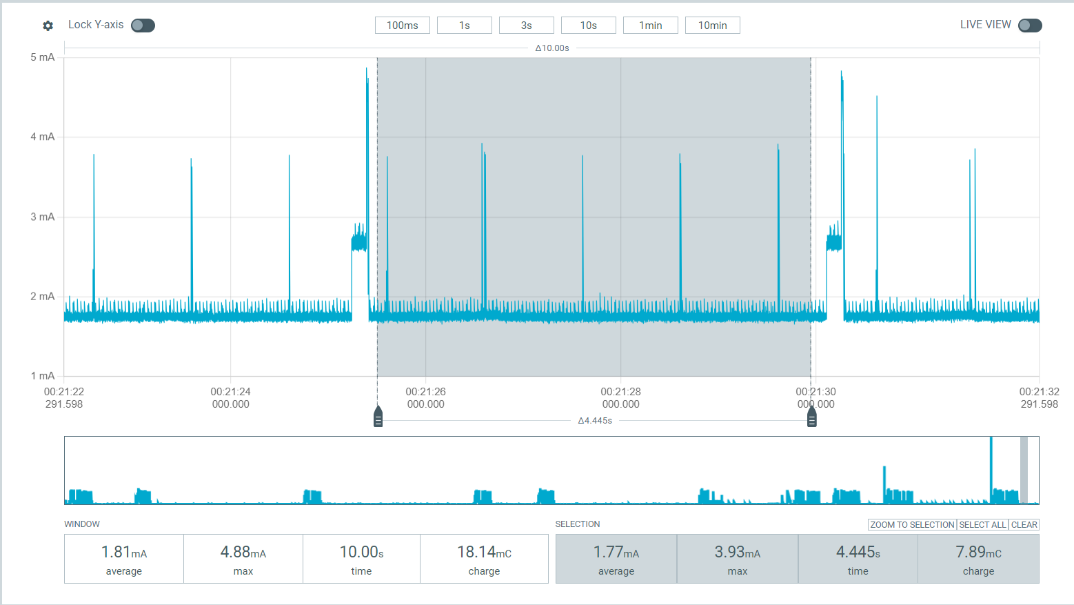

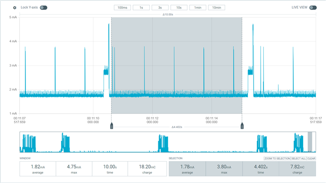

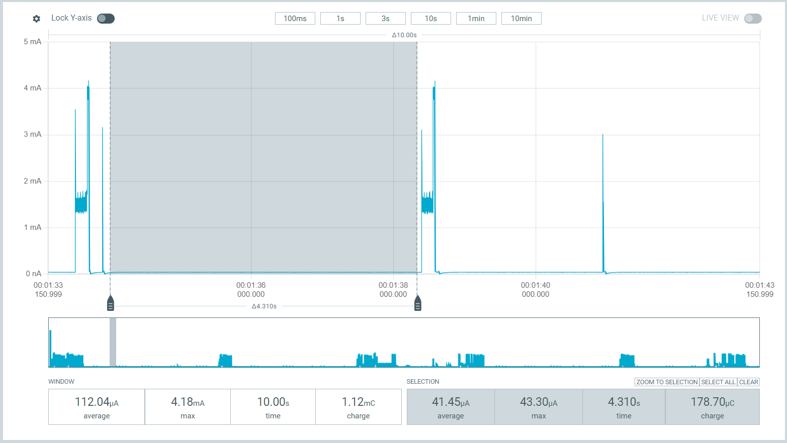

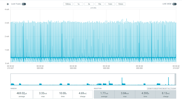

    I went trough the documentation once again and realize that my child imag for the net core didn't had the custom overlay file, so I added that. The power went dows a bit, but not by much and I still have a quite high power consumption avter turning the Wi-Fi OFF a second time.
    Before first Wi-Fi sending
    After first Wi-Fi sending
    Power OFF
    As for the CONFIG_PM, I had this warning, so I figured out it was not supported on the nRF5340. However I have the CONFIG_PM_DEVICE and CONFIG_PM_DEVICE_RUNTIME enabled.

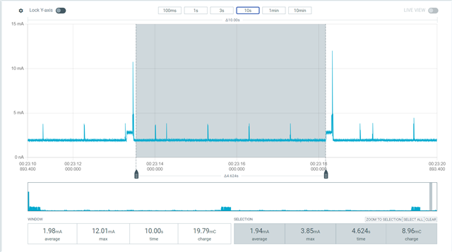

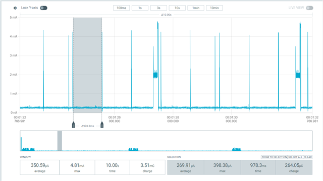

  • Here is a test with the hello world sample. I set every peripheral to disabled (uart too, so UART_CONSOLE=n).
    Debug (before first Wi-Fi ON event)
    Debug (after Wi-Fi OFF)
    Debug (with no contact on UART pins)
    Prod (before first Wi-Fi ON event)
    Prod (after Wi-Fi OFF)
    Prod (poweroff)
