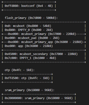

    Yes, now when I shrink code via config and could run build with default partitions, I observed for L05 that fill region in a good way, not sure why they created two empty blocks but maybe this is solution (SIC!) for the gaps

    not sure why (I based on this info, because earlier I tested this on L15) they stick to 0x165000 which is not full 1.5M (3*7d000)

    this is also auto-generated from a simple L15 configuration (thus I guess that for l05 could be same but now I see that they use full available memory so set as the biggest end address 7d000)

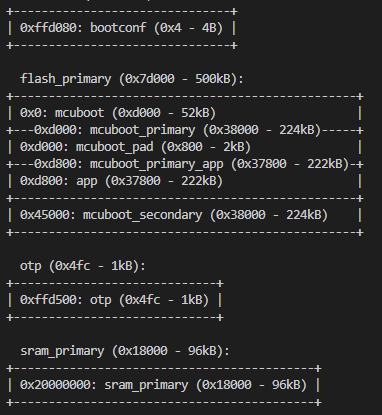

    The EMPTY blocks are for alignment.  Since the gap size between mcuboot and flash_primary for alignment is 0x800, I set CONFIG_PM_PARTITION_SIZE_MCUBOOT=0xd000 in sysbuild/mcuboot.conf for L05 to reduce the mcuboot, which results in a partition without empty blocks.
