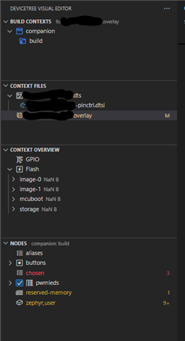

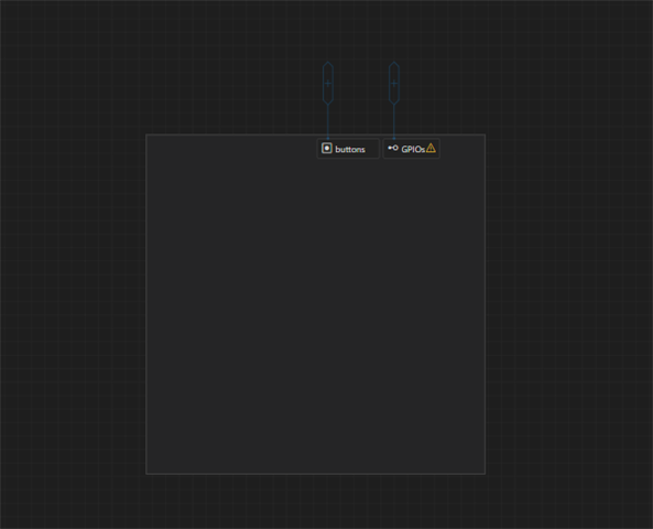

I just updated my vsCode extension and the visual devicetree editor stopped working
I can compile just fine but changing the DT will prove difficult from now on.
This is a current screenshot of my visual editor:

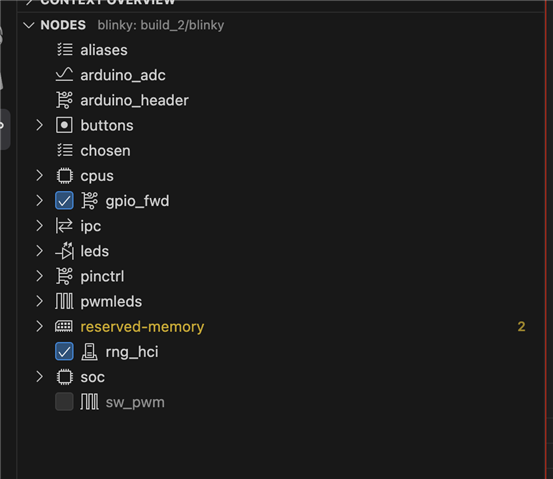

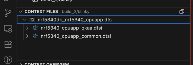

  • Thanks Hendrik,
    1. It looks like the board does not have SOC or CPU nodes. Can you confirm these exist?

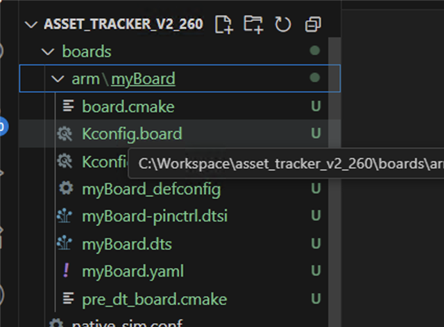

    2. Does the .dts file include any .dtsi files? If so, could you share the paths where the .dtsi paths are relative to the SDK and application?
  • so it appears not to find the corresponding chip-level.dtsi-files.
    Here are my.dts (once again the customers and project name are substituted):

    &pinctrl {
    Here is my DT-overlay:
    // To get started, press Ctrl+Space to bring up the completion menu and view the available nodes.
    // You can also use the buttons in the sidebar to perform actions on nodes.
    // Actions currently available include:
    // * Enabling / disabling the node
    // * Adding the bus to a bus
    // * Removing the node
    // * Connecting ADC channels
    // For more help, browse the DeviceTree documentation at https: //docs.zephyrproject.org/latest/guides/dts/index.html
    // You can also visit the nRF DeviceTree extension documentation at https: //docs.nordicsemi.com/bundle/nrf-connect-vscode/page/guides/ncs_configure_app.html#devicetree-support-in-the-extension
        pwmleds{
            rgb_led_red {
                status = "okay";
                pwms = <&pwm0 0 PWM_MSEC(20) PWM_POLARITY_NORMAL>;
            rgb_led_green {
                status = "okay";
                pwms = <&pwm0 1 PWM_MSEC(20) PWM_POLARITY_NORMAL>;
            rgb_led_blue {
                status = "okay";
                pwms = <&pwm0 2 PWM_MSEC(20) PWM_POLARITY_NORMAL>;
            buzzer {
                status = "okay";
                pwms = <&pwm0 3 PWM_MSEC(20) PWM_POLARITY_NORMAL>;
        aliases {
            ledr = &{/pwmleds/rgb_led_red/};
            ledg = &{/pwmleds/rgb_led_green/};
            ledb = &{/pwmleds/rgb_led_blue/};
            buzzer = &{/pwmleds/buzzer/};
            sw1 = &sw1;
        zephyr,user {
            dip1-gpios = <&gpio0 7 0>;
            dip2-gpios = <&gpio0 8 0>;
            dip3-gpios = <&gpio0 9 0>;
            dip4-gpios = <&gpio0 10 0>;
            usb_fault-gpios = <&gpio0 24 GPIO_ACTIVE_LOW>;
            usb_switch-gpios = <&gpio0 25 GPIO_ACTIVE_LOW>;
            rtc_enable-gpios = <&gpio0 6 0>;
            bmain-gpios = <&gpio0 16 GPIO_ACTIVE_LOW>;
            audio_enable-gpios = <&gpio0 11 GPIO_ACTIVE_LOW>;
        buttons {
            compatible = "gpio-keys";
            sw1: sw1 {
                gpios = <&gpio0 15 0>;
                label = "sw1";
        #address-cells = < 0 >;
        #size-cells = < 0 >;
    &adc {
    	#address-cells = <1>;
    	#size-cells = <0>;
    	status = "okay";
        io-channels = <&adc 0>, <&adc 1>;
    	channel@0 {
    		reg = <0x0>;
    		zephyr,gain = "ADC_GAIN_1_3";
    		zephyr,reference = "ADC_REF_INTERNAL";
    		zephyr,acquisition-time = <ADC_ACQ_TIME_DEFAULT>;
    		zephyr,input-positive = <NRF_SAADC_AIN0>;
    		zephyr,resolution = <12>;
        channel@1 {
    		reg = <0x1>;
    		zephyr,input-positive = <NRF_SAADC_AIN1>;
    &pwm0 {
        pinctrl-0 = <&pwm0_default>;
        pinctrl-names = "default";
    &pinctrl {
    	pwm0_default: pwm0_default {
    		group1 {
    			psels = <NRF_PSEL(PWM_OUT0, 0, 28)>;
    			nordic,invert;
            group2 {
    			psels = <NRF_PSEL(PWM_OUT1, 0, 29)>;
    			nordic,invert;
            group3 {
    			psels = <NRF_PSEL(PWM_OUT2, 0, 30)>;
    			nordic,invert;
            group4 {
    			psels = <NRF_PSEL(PWM_OUT3, 0, 31)>;
        i2c0_default: i2c0_default {
            group1 {
                psels = <NRF_PSEL(TWIM_SDA, 0, 18)>, <NRF_PSEL(TWIM_SCL, 0, 17)>;
        uart0_default: uart0_default {
            group1 {
                psels = <NRF_PSEL(UART_TX, 0, 26)>, <NRF_PSEL(UART_RX, 0, 27)>;
    &i2c0 {
        /**custom_i2c-device definition here.
        * Omitted due to NDA
        pinctrl-0 = <&i2c0_default>;
        clock-frequency = <I2C_BITRATE_FAST>;
    &uart0 {
        status = "okay";
        pinctrl-0 = <&uart0_default>;
        current-speed = <115200>;
        parity = "even";
        stop-bits = "1";
        data-bits = <8>;
    &radio {
        status = "disabled";
    If you need anything else just let me know

  • Have you tested a Nordic sample on a Nordic DK?
    Can you confirm that your custom board is located in /boards/{arch}/{board_name}? Also, could you clarify what the {arch} folder is?
    In the case below, the parent folder of the board is arm. This tells the devicetree to load the arm include path from the SDK.
