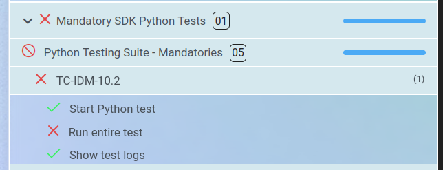

Matter Test Harness failed in TC-IDM-10.2
Hello, Nordic Team!
I am conducting Matter Test Harness testing and have successfully built the test environment. However, I am encountering some issues during test execution.

INFO       | 2025-08-25 12:22:52.088293 | Test Step Completed [PASSED]: Start Python test
INFO       | 2025-08-25 12:22:52.089935 | --------------------------------------------------------------------------------
INFO       | 2025-08-25 12:22:52.106976 | --------------------------------------------------------------------------------
INFO       | 2025-08-25 12:22:52.108564 | Executing Test Step: Run entire test
WARNING    | 2025-08-25 12:22:52.125711 | Test Failure: Python test step failure

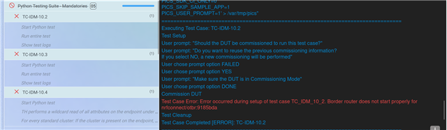

There are also some useful logs.
ubuntu@ubuntu:~/ScriptRunner$ ./OTBRStart.sh
Using BR Interface: wlan0
Using BR Variant: 37
otbr_start.sh: Starting...
otbr_start.sh: Removing 'otbr-chip' container
nrfconnect/otbr                                        9185bda                                    083c8472bc52   2 years ago     1.21GB
otbr image nrfconnect/otbr:9185bda already installed
otbr_start.sh: Starting 'otbr-chip' container
a195577e2a7e0ac850ca65bdaab0eb10e53d5c2304f1adca3f7e34441202a314
otbr_start.sh: Waiting 10 seconds to give the the docker container enough time to start up...
otbr_start.sh: Setting up Thread Network
Param: 'dataset init new'Done
Param: 'dataset channel 25'Done
Param: 'dataset panid 0x5b37'Done
Param: 'dataset extpanid 5b37dead5b37beef'Done
Param: 'dataset networkname 5b37'Done
Param: 'dataset networkkey 00112233445566778899aabbccddeeff'Done
Param: 'dataset commit active'Done
Param: 'prefix add fd11:37::/64 pasor'Done
Param: 'ifconfig up'Done
Param: 'thread start'Done
Param: 'netdata register'Done
Param: 'dataset active -x'0e08000000000001000035060004001fffe00708fd5e18d459de590904109e90c98379c9a88e1ce94b613a1405890c0402a0f7f8000300001901025b3702085b37dead5b37beef030435623337051000112233445566778899aabbccddeeff
Done
Simple Dataset: 000300001902085b37dead5b37beef051000112233445566778899aabbccddeeff01025b37
otbr_start.sh: Restarting the Raspi avahi to have it in a clean state
otbr_start.sh: Finishing...
ubuntu@ubuntu:~/ScriptRunner$ docker ps
CONTAINER ID   IMAGE                                                                     COMMAND                  CREATED              STATUS              PORTS                                                                                          NAMES
5f10d282fd8e   connectedhomeip/chip-cert-bins:1b2b3fd571feaca7328db35798b99ab7ba4e6212   "tail -f /dev/null"      53 seconds ago       Up 53 seconds                                                                                                      th-sdk
a195577e2a7e   nrfconnect/otbr:9185bda                                                   "/app/etc/docker/doc…"   About a minute ago   Up About a minute                                                                                                  otbr-chip
de5a6e52f066   ghcr.io/project-chip/csa-certification-tool-frontend:e3af91a              "docker-entrypoint.s…"   3 days ago           Up 3 days           4200/tcp                                                                                       certification-tool-frontend-1
01ebe05ec272   ghcr.io/project-chip/csa-certification-tool-backend:9bf5d9f               "bash -c './prestart…"   3 days ago           Up 3 days           0.0.0.0:8888->8888/tcp, [::]:8888->8888/tcp, 0.0.0.0:50000->50000/tcp, [::]:50000->50000/tcp   certification-tool-backend-1
817e087de054   postgres:12                                                               "docker-entrypoint.s…"   3 days ago           Up 3 days           0.0.0.0:5432->5432/tcp, [::]:5432->5432/tcp                                                    certification-tool-db-1
879a52b318c8   traefik:v2.2                                                              "/entrypoint.sh --pr…"   3 days ago           Up 3 days           0.0.0.0:80->80/tcp, [::]:80->80/tcp, 0.0.0.0:8090->8080/tcp, [::]:8090->8080/tcp               certification-tool-proxy-1
ubuntu@ubuntu:~/ScriptRunner$ docker ps | grep otbr

Here are my pics files
6254.PICS.zip
And I want to what happen, and how to solve it. My otbr seems fine, because I can run the following command:
ubuntu@ubuntu:~/ScriptRunner$ sudo docker exec -ti otbr-chip ot-ctl state
leader
Done
4606.MatterTH.zip
NCS vesion is v3.0.2. NRF54L15 DK
Thanks!
Xiongwei.Wang

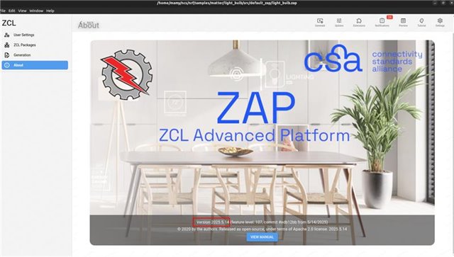

    Key person are out of office this week, but here are some debugging steps you can try:
    Check that the ZAP files have been generated with the version of the ZAP tool supported by the NCS version in use. The supported version can be found in modules/lib/matter/scripts/setup/zap.version. For NCS v3.0.2, the version is v2024.08.14-nightly (from https://github.com/nrfconnect/sdk-connectedhomeip/blob/v3.0.2/scripts/setup/zap.version).
    The version of the ZAP tool being used can be verified by going to Settings > About in the ZAP tool:
    If that doesn't solve it, then what you can try if possible go through the attributes you get an error on in the conformance test, and check that both PICS- and ZAP-files are according to spec. In this particular case you may try debugging log with chatgpt also.
    Kenneth
  • Hi, Kenneth,
    Thank you for your response. It doesn’t seem to be a configuration issue. TC-IDM-10.2 is the first test in my Matter Test Harness, and it didn’t execute the Python script.
    If there’s any additional information I can provide, please let me know.

    It failed while executing the Python script for TC-IDM-10.2.
    These are the logs that show what failed:
    [MatterTest] 08-25 12:22:52.084 INFO ***** Test Step 1 : Run entire test
    success = False
    [MatterTest] 08-25 12:22:52.108 ERROR Exception occurred in test_TC_IDM_10_2.
      File "/usr/local/lib/python3.12/dist-packages/mobly/base_test.py", line 801, in exec_one_test
        test_method()
      File "/root/python_testing/scripts/sdk/TC_DeviceConformance.py", line 462, in test_TC_IDM_10_2
        self.fail_current_test("Problems with conformance")
      File "/usr/local/lib/python3.12/dist-packages/chip/testing/basic_composition.py", line 233, in fail_current_test
        asserts.fail(msg)
      File "/usr/local/lib/python3.12/dist-packages/mobly/asserts.py", line 441, in fail
        raise signals.TestFailure(msg, extras)
    mobly.signals.TestFailure: Details=Problems with conformance, Extras=None
    [MatterTest] 08-25 12:22:52.127 ERROR
    * Test test_TC_IDM_10_2 failed for the following reason:
    * Details=Problems with conformance, Extras=None
    * File "/usr/local/lib/python3.12/dist-packages/chip/testing/basic_composition.py", line 233, in fail_current_test
    * asserts.fail(msg)
    * Test step:
    *     UNKNOWN - no test steps provided in test script
    * Endpoint: None
    [MatterTest] 08-25 12:22:52.128 INFO [Test] test_TC_IDM_10_2 FAIL
    [MatterTest] 08-25 12:22:52.135 INFO ###########################################################
    [MatterTest] 08-25 12:22:52.135 INFO Problems found:
    [MatterTest] 08-25 12:22:52.136 INFO ===============
    Problem: ProblemSeverity.ERROR
        test_name: IDM-10.2
        location:
           Endpoint: 0,
           Cluster:  49 (0x31) NetworkCommissioning
          Attribute:8 (0x08)
        problem: Attribute 0x08 is included, but is disallowed by conformance. Conformance: WI, implemented features: TH
        spec_location:
    [MatterTest] 08-25 12:22:52.137 INFO
        test_name: IDM-10.2
        location:
           Endpoint: 0,
           Cluster:  53 (0x35) ThreadNetworkDiagnostics
          Attribute:6 (0x06)
        problem: Attribute 0x06 is included, but is disallowed by conformance. Conformance: ERRCNT, implemented features:
        spec_location:
        test_name: IDM-10.2
        location:
           Endpoint: 0,
          Attribute:14 (0x0e)
        problem: Attribute 0x0e is included, but is disallowed by conformance. Conformance: [MLECNT], implemented features:
        spec_location:
    [MatterTest] 08-25 12:22:52.138 INFO
        test_name: IDM-10.2
        location:
           Endpoint: 0,
          Attribute:15 (0x0f)
        problem: Attribute 0x0f is included, but is disallowed by conformance. Conformance: [MLECNT], implemented features:
        spec_location:
        test_name: IDM-10.2
        location:
           Endpoint: 0,
          Attribute:16 (0x10)
        problem: Attribute 0x10 is included, but is disallowed by conformance. Conformance: [MLECNT], implemented features:
        spec_location:
    [MatterTest] 08-25 12:22:52.139 INFO
        test_name: IDM-10.2
        location:
           Endpoint: 0,
          Attribute:17 (0x11)
        problem: Attribute 0x11 is included, but is disallowed by conformance. Conformance: [MLECNT], implemented features:
        spec_location:
    [MatterTest] 08-25 12:22:52.140 INFO
        test_name: IDM-10.2
        location:
           Endpoint: 0,
          Attribute:18 (0x12)
        problem: Attribute 0x12 is included, but is disallowed by conformance. Conformance: [MLECNT], implemented features:
        spec_location:
        test_name: IDM-10.2
        location:
           Endpoint: 0,
          Attribute:19 (0x13)
        problem: Attribute 0x13 is included, but is disallowed by conformance. Conformance: [MLECNT], implemented features:
        spec_location:
    [MatterTest] 08-25 12:22:52.141 INFO
        test_name: IDM-10.2
        location:
           Endpoint: 0,
          Attribute:20 (0x14)
        problem: Attribute 0x14 is included, but is disallowed by conformance. Conformance: [MLECNT], implemented features:
        spec_location:
        test_name: IDM-10.2
        location:
           Endpoint: 0,
          Attribute:21 (0x15)
        problem: Attribute 0x15 is included, but is disallowed by conformance. Conformance: [MLECNT], implemented features:
        spec_location:
    [MatterTest] 08-25 12:22:52.142 INFO
        test_name: IDM-10.2
        location:
           Endpoint: 0,
          Attribute:22 (0x16)
        problem: Attribute 0x16 is included, but is disallowed by conformance. Conformance: [MACCNT], implemented features:
        spec_location:
        test_name: IDM-10.2
        location:
           Endpoint: 0,
          Attribute:23 (0x17)
        problem: Attribute 0x17 is included, but is disallowed by conformance. Conformance: [MACCNT], implemented features:
        spec_location:
    [MatterTest] 08-25 12:22:52.143 INFO
        test_name: IDM-10.2
        location:
           Endpoint: 0,
          Attribute:24 (0x18)
        problem: Attribute 0x18 is included, but is disallowed by conformance. Conformance: [MACCNT], implemented features:
        spec_location:
        test_name: IDM-10.2
        location:
           Endpoint: 0,
          Attribute:25 (0x19)
        problem: Attribute 0x19 is included, but is disallowed by conformance. Conformance: [MACCNT], implemented features:
        spec_location:
    [MatterTest] 08-25 12:22:52.144 INFO
        test_name: IDM-10.2
        location:
           Endpoint: 0,
          Attribute:26 (0x1a)
        problem: Attribute 0x1a is included, but is disallowed by conformance. Conformance: [MACCNT], implemented features:
        spec_location:
        test_name: IDM-10.2
        location:
           Endpoint: 0,
          Attribute:27 (0x1b)
        problem: Attribute 0x1b is included, but is disallowed by conformance. Conformance: [MACCNT], implemented features:
        spec_location:
        test_name: IDM-10.2
        location:
           Endpoint: 0,
          Attribute:28 (0x1c)
        problem: Attribute 0x1c is included, but is disallowed by conformance. Conformance: [MACCNT], implemented features:
        spec_location:
    [MatterTest] 08-25 12:22:52.145 INFO
        test_name: IDM-10.2
        location:
           Endpoint: 0,
          Attribute:29 (0x1d)
        problem: Attribute 0x1d is included, but is disallowed by conformance. Conformance: [MACCNT], implemented features:
        spec_location:
        test_name: IDM-10.2
        location:
           Endpoint: 0,
          Attribute:30 (0x1e)
        problem: Attribute 0x1e is included, but is disallowed by conformance. Conformance: [MACCNT], implemented features:
        spec_location:
    [MatterTest] 08-25 12:22:52.146 INFO
        test_name: IDM-10.2
        location:
           Endpoint: 0,
          Attribute:31 (0x1f)
        problem: Attribute 0x1f is included, but is disallowed by conformance. Conformance: [MACCNT], implemented features:
        spec_location:
        test_name: IDM-10.2
        location:
           Endpoint: 0,
          Attribute:32 (0x20)
        problem: Attribute 0x20 is included, but is disallowed by conformance. Conformance: [MACCNT], implemented features:
        spec_location:
        test_name: IDM-10.2
        location:
           Endpoint: 0,
          Attribute:33 (0x21)
        problem: Attribute 0x21 is included, but is disallowed by conformance. Conformance: [MACCNT], implemented features:
        spec_location:
    [MatterTest] 08-25 12:22:52.147 INFO
        test_name: IDM-10.2
        location:
           Endpoint: 0,
          Attribute:34 (0x22)
        problem: Attribute 0x22 is included, but is disallowed by conformance. Conformance: [MACCNT], implemented features:
        spec_location:
        test_name: IDM-10.2
        location:
           Endpoint: 0,
          Attribute:35 (0x23)
        problem: Attribute 0x23 is included, but is disallowed by conformance. Conformance: [MACCNT], implemented features:
        spec_location:
    [MatterTest] 08-25 12:22:52.148 INFO
        test_name: IDM-10.2
        location:
           Endpoint: 0,
          Attribute:36 (0x24)
        problem: Attribute 0x24 is included, but is disallowed by conformance. Conformance: [MACCNT], implemented features:
        spec_location:
        test_name: IDM-10.2
        location:
           Endpoint: 0,
          Attribute:37 (0x25)
        problem: Attribute 0x25 is included, but is disallowed by conformance. Conformance: [MACCNT], implemented features:
        spec_location:
    [MatterTest] 08-25 12:22:52.149 INFO
        test_name: IDM-10.2
        location:
           Endpoint: 0,
          Attribute:38 (0x26)
        problem: Attribute 0x26 is included, but is disallowed by conformance. Conformance: [MACCNT], implemented features:
        spec_location:
        test_name: IDM-10.2
        location:
           Endpoint: 0,
          Attribute:39 (0x27)
        problem: Attribute 0x27 is included, but is disallowed by conformance. Conformance: [MACCNT], implemented features:
        spec_location:
    [MatterTest] 08-25 12:22:52.150 INFO
        test_name: IDM-10.2
        location:
           Endpoint: 0,
          Attribute:40 (0x28)
        problem: Attribute 0x28 is included, but is disallowed by conformance. Conformance: [MACCNT], implemented features:
        spec_location:
        test_name: IDM-10.2
        location:
           Endpoint: 0,
          Attribute:41 (0x29)
        problem: Attribute 0x29 is included, but is disallowed by conformance. Conformance: [MACCNT], implemented features:
        spec_location:
    [MatterTest] 08-25 12:22:52.151 INFO
        test_name: IDM-10.2
        location:
           Endpoint: 0,
          Attribute:42 (0x2a)
        problem: Attribute 0x2a is included, but is disallowed by conformance. Conformance: [MACCNT], implemented features:
        spec_location:
        test_name: IDM-10.2
        location:
           Endpoint: 0,
          Attribute:43 (0x2b)
        problem: Attribute 0x2b is included, but is disallowed by conformance. Conformance: [MACCNT], implemented features:
        spec_location:
    [MatterTest] 08-25 12:22:52.152 INFO
        test_name: IDM-10.2
        location:
           Endpoint: 0,
          Attribute:44 (0x2c)
        problem: Attribute 0x2c is included, but is disallowed by conformance. Conformance: [MACCNT], implemented features:
        spec_location:
        test_name: IDM-10.2
        location:
           Endpoint: 0,
          Attribute:45 (0x2d)
        problem: Attribute 0x2d is included, but is disallowed by conformance. Conformance: [MACCNT], implemented features:
        spec_location:
    [MatterTest] 08-25 12:22:52.153 INFO
        test_name: IDM-10.2
        location:
           Endpoint: 0,
          Attribute:46 (0x2e)
        problem: Attribute 0x2e is included, but is disallowed by conformance. Conformance: [MACCNT], implemented features:
        spec_location:
        test_name: IDM-10.2
        location:
           Endpoint: 0,
          Attribute:47 (0x2f)
        problem: Attribute 0x2f is included, but is disallowed by conformance. Conformance: [MACCNT], implemented features:
        spec_location:
    [MatterTest] 08-25 12:22:52.154 INFO
        test_name: IDM-10.2
        location:
           Endpoint: 0,
          Attribute:48 (0x30)
        problem: Attribute 0x30 is included, but is disallowed by conformance. Conformance: [MACCNT], implemented features:
        spec_location:
        test_name: IDM-10.2
        location:
           Endpoint: 0,
          Attribute:49 (0x31)
        problem: Attribute 0x31 is included, but is disallowed by conformance. Conformance: [MACCNT], implemented features:
        spec_location:
    [MatterTest] 08-25 12:22:52.155 INFO
        test_name: IDM-10.2
        location:
           Endpoint: 0,
           Cluster:  56 (0x38) TimeSynchronization
          Attribute:4 (0x04)
        problem: Attribute 0x04 is included, but is disallowed by conformance. Conformance: NTPC, implemented features: TZ,TSC
        spec_location:

           Command:  3 (0x03)
        problem: Command 0x03 is required, but is not present on the DUT. Conformance: M, implemented features: GN
        spec_location:
    [MatterTest] 08-25 12:22:52.171 INFO
        test_name: Choice conformance
        location:
           Endpoint: 16,
           Cluster:  258 (0x102) WindowCovering
          Attribute:65532 (0xfffc)
        problem: Problem with choice conformance .a+ - 0 selected
        spec_location:
        test_name: IDM-10.2
        location:
           Endpoint: 16,
           Cluster:  768 (0x300) ColorControl
           Command:  64 (0x40)
        problem: Command 0x40 is included, but disallowed by conformance. Conformance: EHUE, implemented features: HS,XY,CT
        spec_location:
        test_name: IDM-10.2
        location:
           Endpoint: 16,
           Command:  71 (0x47)
        problem: Command 0x47 is required, but is not present on the DUT. Conformance: HS | XY | CT, implemented features: HS,XY,CT
        spec_location:
    [MatterTest] 08-25 12:22:52.172 INFO
        test_name: IDM-10.2
        location:
           Endpoint: 16,
           Command:  75 (0x4b)
        problem: Command 0x4b is required, but is not present on the DUT. Conformance: CT, implemented features: HS,XY,CT
        spec_location:
        test_name: IDM-10.2
        location:
           Endpoint: 16,
           Command:  76 (0x4c)
        problem: Command 0x4c is required, but is not present on the DUT. Conformance: CT, implemented features: HS,XY,CT
        spec_location:
        test_name: IDM-10.2
        location:
           Endpoint: 17,
           Cluster:  4 (0x04) Groups
           Command:  0 (0x00)
        problem: Command 0x00 is required, but is not present on the DUT. Conformance: M, implemented features: GN
        spec_location:
    [MatterTest] 08-25 12:22:52.173 INFO
        test_name: IDM-10.2
        location:
           Endpoint: 17,
           Command:  1 (0x01)
        problem: Command 0x01 is required, but is not present on the DUT. Conformance: M, implemented features: GN
        spec_location:
        test_name: IDM-10.2
        location:
           Endpoint: 17,
           Command:  2 (0x02)
        problem: Command 0x02 is required, but is not present on the DUT. Conformance: M, implemented features: GN
        spec_location:
        test_name: IDM-10.2
        location:
           Endpoint: 17,
           Command:  3 (0x03)
        spec_location:
    [MatterTest] 08-25 12:22:52.174 INFO
        test_name: IDM-10.2
        location:
           Endpoint: 17,
           Command:  4 (0x04)
        problem: Command 0x04 is required, but is not present on the DUT. Conformance: M, implemented features: GN
        spec_location:
        test_name: IDM-10.2
        location:
           Endpoint: 17,
           Command:  5 (0x05)
        problem: Command 0x05 is required, but is not present on the DUT. Conformance: M, implemented features: GN
        spec_location:
        test_name: IDM-10.2
        location:
           Endpoint: 17,
           Command:  0 (0x00)
        spec_location:
    [MatterTest] 08-25 12:22:52.175 INFO
        test_name: IDM-10.2
        location:
           Endpoint: 17,
           Command:  1 (0x01)
        spec_location:
        test_name: IDM-10.2
        location:
           Endpoint: 17,
           Command:  2 (0x02)
        spec_location:
        test_name: IDM-10.2
        location:
           Endpoint: 17,
           Command:  3 (0x03)
        spec_location:
    [MatterTest] 08-25 12:22:52.176 INFO ###########################################################
    [MatterTest] 08-25 12:22:52.177 INFO Summary for test class TC_DeviceConformance: Error 0, Executed 1, Failed 1, Passed 0, Requested 1, Skipped 0
    [MatterTest] 08-25 12:22:52.179 INFO Summary for test run MatterTest@08-25-2025_12-22-20-576:
    Total time elapsed 31.552026929042768s
    Artifacts are saved in "/tmp/matter_testing/logs/MatterTest/08-25-2025_12-22-20-576"
    Test summary saved in "/tmp/matter_testing/logs/MatterTest/08-25-2025_12-22-20-576/test_summary.yaml"
    Test results: Error 0, Executed 1, Failed 1, Passed 0, Requested 1, Skipped 0
    According to this, there are multiple attributes that are included on your device, but that are disallowed by conformance.
    Please verify that you have all the required PICS, that they conform to the specification for the Matter version you are using, and that you have provided all of them to the Test Harness. You need to provide Base.xml and PICS for each cluster implemented on the device. We have example PICS for the Matter Weather Station, which you can take a look at: https://github.com/nrfconnect/sdk-nrf/tree/v2.1.4/applications/matter_weather_station/certification/PICS. These PICS are from nRF Connect SDK v2.1.4, so they are a few years old, but it is just to give a general idea of what files you need, etc.
    Marte
  • Hi Marte,
    Thank you very much for your help once again. You are very experienced. As I am new to the Matter Test Harness, please forgive me for not noticing the issues you pointed out earlier. I will look into this tomorrow.
