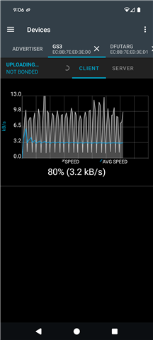

We are trying to increase the upload speed of our BMD-350 module. Right now we are averaging about 3kB/s according to nRFConnect.
See attached image of upload plot according to nRFConnect.
Let me know if this slow upload speed is expected or if this is abnormal.
