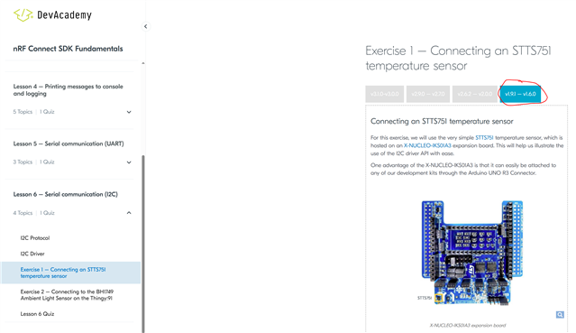

  • Sorry, I read that a little fast. I thought you wanted to port the entire application to NCS v3.X.X.
    Either way, note that in the course, you can select the NCS version on top (in those places where the NCS versions affect the behavior):
