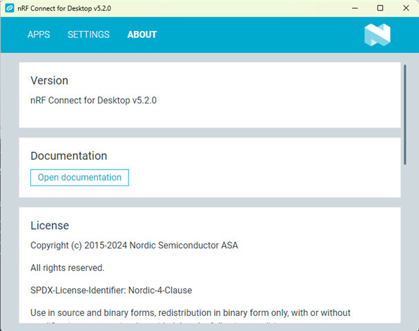

Applications Versions:
  1. nRF connection Desktop v5.2.0
  2. Toolchain Manager v1.6.0
  3. Visual studio cade v2.9.2
  4. Windows 11 pro Platform

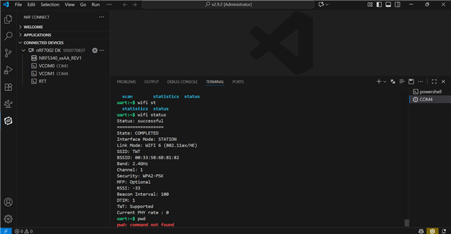

    What access point are you using? It could be that the access point does not support TWT.
    Can you share device logs when enabling TWT? You can also try the Wi-Fi TWT sample.

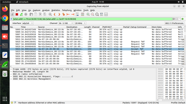

    We are currently using a FreeBox Access Point, which supports TWT (Target Wake Time) power save mode. In the packet capture, we can see both the TWT Request and Accept frames. However, the client is still not entering power save mode.
    TWT enabling logs:-
    uart:~$ wifi twt setup 0 0 2 2 0 1 1 1 2000 60000
    TWT operation TWT setup with dg: 2, flow_id: 2 requested
    TWT response: TWT accept
    == TWT negotiated parameters ==
    TWT Dialog token: 2
    TWT flow ID: 1
    TWT negotiation type: TWT individual negotiation
    TWT responder: true
    TWT implicit: true
    TWT announce: true
    TWT trigger: true
    TWT wake interval: 2048 us
    TWT interval: 60000 us
    For your reference Pcap screenshot attached below.

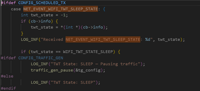

    Based on the logs with the TWT sample, the device enters sleep mode as it should, so this is most likely also the case when you use the shell sample. In other words, you can chose to use the TWT sample I shared or the Wi-Fi shell sample in the SDK for TWT.
    If you want to use the TWT sample I shared, you can enable zperf by adding the following in prj.conf:
    CONFIG_NET_SHELL=y
    CONFIG_NET_ZPERF=y
    CONFIG_ZVFS_OPEN_MAX=12
    This lets you use iperf/zperf as in the Wi-Fi Throughput sample, i.e., you can use the following command on the nRF7002:
    zperf udp upload <ipaddress> 5001 10 1K 50M
    zperf udp download 5001

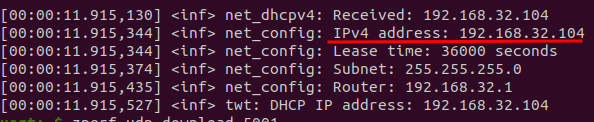

    If you get any errors, you might have to increase CONFIG_ZVFS_OPEN_MAX and CONFIG_NET_SOCKETS_POLL_MAX. You should also remove CONFIG_NET_CONFIG_MY_IPV4_ADDR from prj.conf, as if you have this, zperf will try to use the address set there instead of the device's actual address. You can see the device's address in the log:

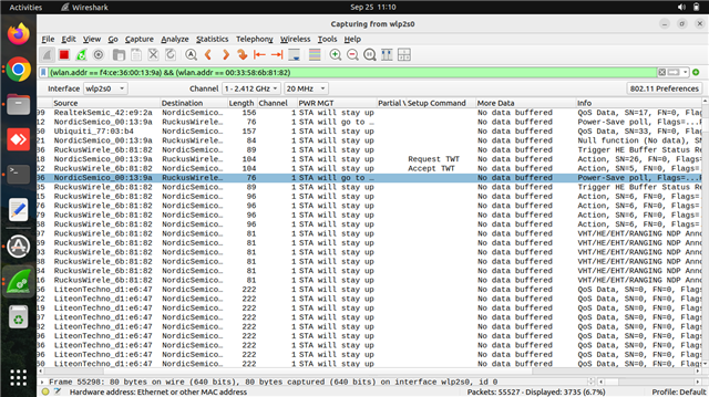

    As you mentioned, we are getting logs in the TWT sample. However, in the Pcap capture, we are not able to see the client entering sleep mode. For your reference, I have attached the Pcap files
