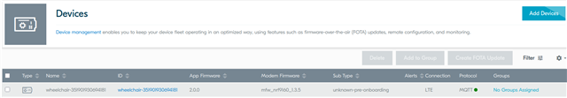

I am facing an issue with nRF Cloud device provisioning. I am using the nrfcloud-util tool to provision the device to nRF Cloud (as recommended for production provisioning).
From the logs (attached from both the device and nrfcloud-util), the device successfully connects to nRF Cloud. However, in the nRF Cloud Device Portal, the device status does not change from “Unknown (Pre-Onboarding)”.
According to DevZone, the possible reasons could be:
  • Incorrect device ID
  • Device not provisioned correctly
  • Certificate mismatch
In my case:
  • Device ID is correct
  • Provisioning is successful (logs confirm the device connects to nRF Cloud)
  • Certificates are valid (device connection proves this)
References:
  • Attached: device debug logs and device ID(wheelchair-351901930694181)
  • Hardware: nRF9160 DK
  • Sample: nRF Cloud Multi-Service sample
  • Currently testing with DK, but will use custom PCB later, so provisioning via nrfcloud-util must work reliably.
Issue:
Device remains in “Unknown (Pre-Onboarding)” state in nRF Cloud despite successful provisioning and connection.
Request:
Need guidance/solution for why the device status is not updating and how to resolve this issue.
kind Regards
Akbar Shah
