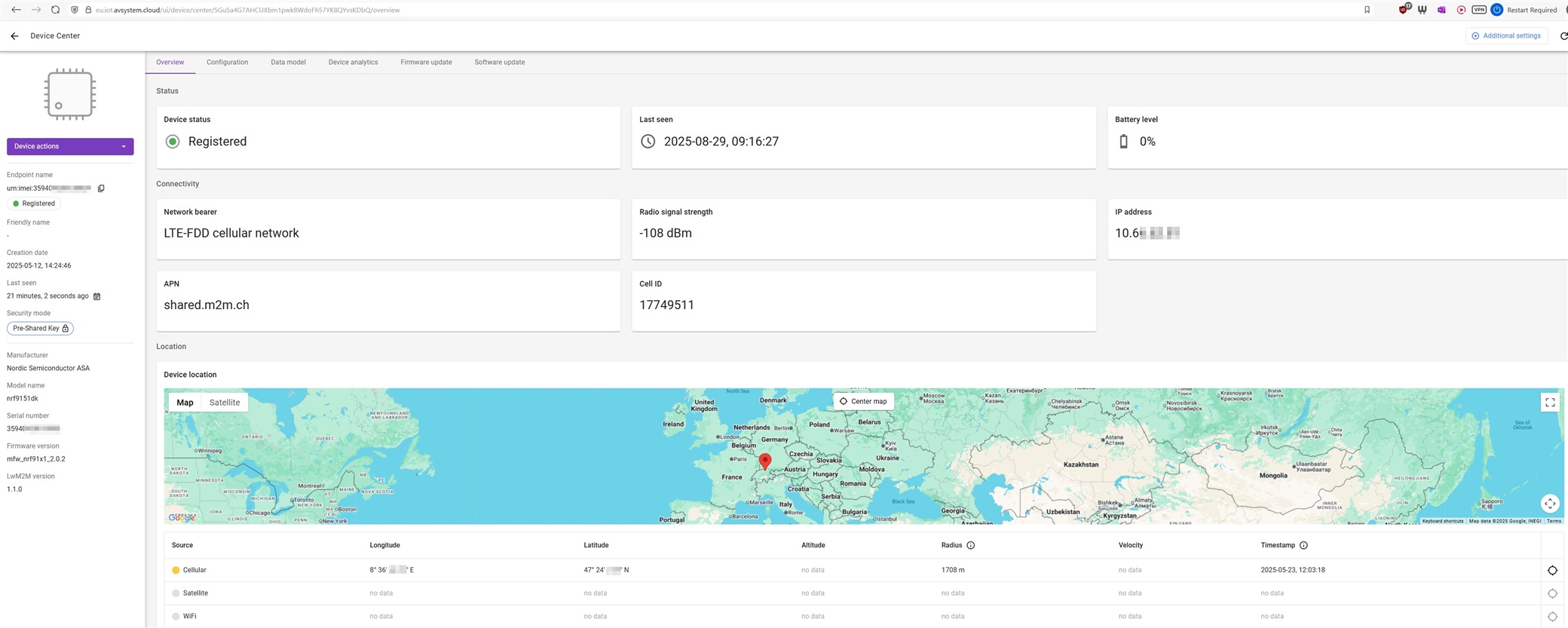

This was working the last months as you can see in the screenshot below showing an old cell-based fix of my daily nrf9151DK:
This week I realized I dont see any location of any registered device anymore. To verify, that not our own changes did break something I did recreate the original setup

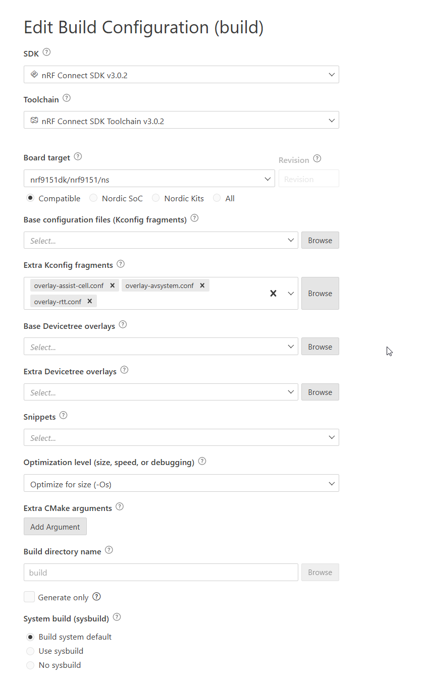

- nrf9151DK
- SDK 3.0.2
- nrf/lwm2m_client sample
- extra kconfig fragments: overlay-avsystems.conf, overlay-assist-cell.conf, overlay-rtt.conf (log and shell via Segger RTT instead of UART)
- build and flash

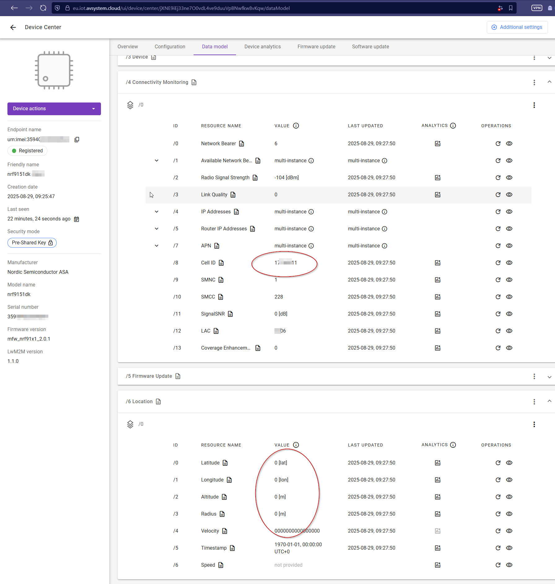

- created a fresh account on AVsystems coiote, setup my ndk
- powered on the device
- coiote shows "device last seen X seconds ago"
below you can see a couple of logs running this sample firmware - it always shows localization errors on the console, coiote sees the device lwm2m-tree, the device' cellid on /4/0/8 but the device never gets a fix and therefore /6/0/* never gets set long/lat values:

    I tested the lwm2m_client sample using your configuration. When I triggered a location update by pressing Button 2, the cellular location was successfully updated on AVSystem’s Coiote server.
    Juha
  • thanks for testing. Could you please elaborate a little bit more about your setup and environment as a lot of things are not working as expected on fresh Windows 11 installations like debugging etc.pp.
  • I did the same and it doesnt. This is the log output of the sample build with SDK v3.0.2, on Ubuntu 24.04 within VSCode and flashed to a nRF9151 DK

    dl-sh:~$ [00:00:05.528,930] <inf> app_lwm2m_client: LwM2M is connecting to server
    dl-sh:~$ dl-sh:~$ [00:00:06.346,313] <err> lte_lc: Sending AT%NCELLMEAS failed, error: 131589
    dl-sh:~$ [00:00:06.412,750] <inf> lwm2m_security: Requesting LTE and GNSS online
    dl-sh:~$ dl-sh:~$ [00:00:07.460,968] <dbg> app_lwm2m_client: lwm2m_lte_reg_handler_notify: LTE NW status: 2
    dl-sh:~$ [00:00:08.019,317] <inf> lwm2m_security: Modem connection restored
    dl-sh:~$ [00:00:08.019,836] <dbg> app_lwm2m_client: lwm2m_lte_reg_handler_notify: LTE NW status: 1
    dl-sh:~$ [00:00:08.021,270] <inf> app_lwm2m_client: LwM2M is connecting to server
    dl-sh:~$ [00:00:08.329,406] <inf> net_lwm2m_engine: Connected, sock id 1
    dl-sh:~$ dl-sh:~$ [00:00:08.661,499] <dbg> app_lwm2m_client: rd_client_event: Registration complete
    dl-sh:~$ [00:00:08.661,590] <inf> net_lwm2m_rd_client: Registration Done (EP='urn:imei:3594XXXXX130024')
    dl-sh:~$ [00:00:08.662,139] <inf> app_lwm2m_client: LwM2M is connected to server
    dl-sh:~$ [00:00:08.662,200] <inf> app_lwm2m_client: Obtained date-time from modem
    dl-sh:~$ dl-sh:~$
    dl-sh:~$
    dl-sh:~$
    dl-sh:~$ [00:00:44.931,396] <inf> lwm2m_rai: RAI enabled
    dl-sh:~$ [00:00:44.931,427] <dbg> app_lwm2m_client: rd_client_event: Queue mode RX window closed
    dl-sh:~$ [00:00:45.801,544] <inf> app_lwm2m_client: Send cell location request event
    dl-sh:~$ [00:00:45.801,666] <dbg> app_lwm2m: app_event_handler: Button 2 changed state to 1.
    dl-sh:~$ [00:00:45.805,145] <inf> net_lwm2m_message_handling: Send op to server (/dp)
    dl-sh:~$ [00:00:45.805,328] <dbg> app_lwm2m_client: rd_client_event: Registration update started
    dl-sh:~$ dl-sh:~$ [00:00:45.983,123] <dbg> app_lwm2m: app_event_handler: Button 2 changed state to 0.
    dl-sh:~$ [00:00:46.216,156] <inf> net_lwm2m_rd_client: Update callback (code:2.4)
    dl-sh:~$ [00:00:46.216,217] <dbg> app_lwm2m_client: rd_client_event: Registration update complete
    dl-sh:~$ [00:00:46.216,247] <inf> net_lwm2m_rd_client: Update Done
    dl-sh:~$ [00:00:46.303,222] <inf> net_lwm2m_message_handling: Send done!
    dl-sh:~$ [00:00:46.821,655] <err> net_lwm2m_obj_ground_fix: Ground Fix result Temporary error (1)
    dl-sh:~$ [00:00:46.824,676] <inf> lwm2m_rai: Ongoing traffic, RAI disabled
    dl-sh:~$ dl-sh:~$ [00:01:16.825,347] <inf> lwm2m_rai: RAI enabled
    dl-sh:~$ [00:01:16.825,378] <dbg> app_lwm2m_client: rd_client_event: Queue mode RX window closed
    dl-sh:~$ dl-sh:~$ [00:01:46.925,170] <dbg> app_lwm2m_client: rd_client_event: Registration update started
    dl-sh:~$ dl-sh:~$ [00:01:48.127,044] <inf> net_lwm2m_rd_client: Update callback (code:2.4)
    dl-sh:~$ [00:01:48.127,105] <dbg> app_lwm2m_client: rd_client_event: Registration update complete
    dl-sh:~$ [00:01:48.127,136] <inf> net_lwm2m_rd_client: Update Done
    dl-sh:~$ dl-sh:~$ [00:02:18.128,814] <dbg> app_lwm2m_client: rd_client_event: Queue mode RX window closed
    dl-sh:~$ dl-sh:~$ [00:02:46.924,255] <dbg> app_lwm2m_client: rd_client_event: Registration update started
    dl-sh:~$ dl-sh:~$ [00:02:48.256,317] <inf> net_lwm2m_rd_client: Update callback (code:2.4)
    dl-sh:~$ [00:02:48.256,378] <dbg> app_lwm2m_client: rd_client_event: Registration update complete
    dl-sh:~$ [00:02:48.256,408] <inf> net_lwm2m_rd_client: Update Done
    dl-sh:~$ dl-sh:~$ [00:03:17.068,267] <dbg> app_lwm2m_client: rd_client_event: Queue mode RX window closed
    dl-sh:~$ dl-sh:~$ [00:03:46.825,042] <err> net_lwm2m_obj_ground_fix: Ground Fix result No response (2)
    dl-sh:~$ [00:03:46.825,073] <err> net_lwm2m_location_assist: No response error in location services
    dl-sh:~$ dl-sh:~$
  • I tried 2 different locations (home and office), 2 SIM cards (Onomondo, Swisscom), both  connected to coiote backend via LTE-M - no cell based localisation working.
  • sdk and sample v3.1.0, created and built on Ubuntu 24.04 LTS
    dl-sh:~$ *** Booting nRF Connect SDK v3.1.0-6c6e5b32496e ***
    dl-sh:~$ *** Using Zephyr OS v4.1.99-1612683d4010 ***
    dl-sh:~$ [00:00:00.259,216] <inf> app_lwm2m_client: Run LWM2M client
    dl-sh:~$ [00:00:00.593,719] <inf> app_lwm2m_client: endpoint: urn:imei:359404230130024
    dl-sh:~$ [00:00:01.027,557] <inf> lwm2m_lte_notification: Registering ncell notification handler
    dl-sh:~$ [00:00:01.027,648] <inf> lwm2m_firmware: Image is confirmed OK
    dl-sh:~$ [00:00:01.027,648] <inf> app_lwm2m_client: Connecting to network.
    dl-sh:~$ [00:00:01.027,679] <inf> app_lwm2m_client: This may take several minutes.
    dl-sh:~$ dl-sh:~$ [00:00:03.380,798] <dbg> app_lwm2m_client: lwm2m_lte_reg_handler_notify: LTE NW status: 2
    dl-sh:~$ dl-sh:~$ [00:00:04.831,298] <dbg> app_lwm2m_client: lwm2m_lte_reg_handler_notify: LTE NW status: 1
    dl-sh:~$ [00:00:04.832,031] <inf> app_lwm2m_client: Connected to LTE network
    dl-sh:~$ [00:00:04.837,951] <inf> app_lwm2m_client: Client connect to server
    dl-sh:~$ [00:00:04.838,134] <inf> net_lwm2m_rd_client: Start LWM2M Client: urn:imei:359404230130024
    dl-sh:~$ [00:00:04.838,195] <inf> app_lwm2m_client: LwM2M is connecting to server
    dl-sh:~$ [00:00:04.838,500] <inf> net_lwm2m_rd_client: RD Client started with endpoint 'urn:imei:359404230130024' with client lifetime 43200 using server object 0
    dl-sh:~$ [00:00:05.114,593] <inf> lwm2m_security: Need to write credentials, requesting LTE and GNSS offline...
    dl-sh:~$ [00:00:05.152,374] <dbg> app_lwm2m_client: lwm2m_lte_reg_handler_notify: LTE NW status: 0
    dl-sh:~$ [00:00:05.152,526] <inf> app_lwm2m_client: LwM2M is connecting to server
    dl-sh:~$ dl-sh:~$ [00:00:06.289,001] <err> lte_lc: Sending AT%NCELLMEAS failed, error: 131589
    dl-sh:~$ [00:00:06.355,438] <inf> lwm2m_security: Requesting LTE and GNSS online
    dl-sh:~$ dl-sh:~$ [00:00:07.421,356] <dbg> app_lwm2m_client: lwm2m_lte_reg_handler_notify: LTE NW status: 2
    dl-sh:~$ [00:00:08.135,955] <inf> lwm2m_security: Modem connection restored
    dl-sh:~$ [00:00:08.136,505] <dbg> app_lwm2m_client: lwm2m_lte_reg_handler_notify: LTE NW status: 1
    dl-sh:~$ [00:00:08.137,725] <inf> app_lwm2m_client: LwM2M is connecting to server
    dl-sh:~$ dl-sh:~$ [00:00:08.509,033] <inf> net_lwm2m_engine: Connected, sock id 1
    dl-sh:~$ [00:00:08.835,388] <dbg> app_lwm2m_client: rd_client_event: Registration complete
    dl-sh:~$ [00:00:08.835,479] <inf> net_lwm2m_rd_client: Registration Done (EP='urn:imei:359404230130024')
    dl-sh:~$ [00:00:08.838,745] <inf> app_lwm2m_client: LwM2M is connected to server
    dl-sh:~$ [00:00:08.838,806] <inf> app_lwm2m_client: Obtained date-time from modem
    dl-sh:~$ dl-sh:~$ [00:00:35.028,442] <inf> app_lwm2m_client: Send cell location request event
    dl-sh:~$ [00:00:35.028,594] <dbg> app_lwm2m: app_event_handler: Button 2 changed state to 1.
    dl-sh:~$ [00:00:35.032,073] <inf> net_lwm2m_message_handling: Send op to server (/dp)
    dl-sh:~$ [00:00:35.189,697] <dbg> app_lwm2m: app_event_handler: Button 2 changed state to 0.
    dl-sh:~$ [00:00:35.390,869] <inf> net_lwm2m_message_handling: Send done!
    dl-sh:~$ dl-sh:~$ [00:00:37.108,062] <err> net_lwm2m_obj_ground_fix: Ground Fix result Temporary error (1)
    dl-sh:~$ dl-sh:~$ [00:01:07.109,924] <inf> lwm2m_rai: RAI enabled
    dl-sh:~$ [00:01:07.109,954] <dbg> app_lwm2m_client: rd_client_event: Queue mode RX window closed
    dl-sh:~$ dl-sh:~$ [00:01:09.023,376] <dbg> app_lwm2m_client: rd_client_event: Registration update started
    dl-sh:~$ [00:01:09.653,594] <inf> net_lwm2m_rd_client: Update callback (code:2.4)
    dl-sh:~$ [00:01:09.653,656] <dbg> app_lwm2m_client: rd_client_event: Registration update complete
    dl-sh:~$ [00:01:09.653,686] <inf> net_lwm2m_rd_client: Update Done
    dl-sh:~$ dl-sh:~$ [00:01:37.208,770] <dbg> app_lwm2m_client: rd_client_event: Registration update started
    dl-sh:~$ [00:01:38.094,787] <inf> net_lwm2m_rd_client: Update callback (code:2.4)
    dl-sh:~$ [00:01:38.094,848] <dbg> app_lwm2m_client: rd_client_event: Registration update complete
    dl-sh:~$ [00:01:38.094,879] <inf> net_lwm2m_rd_client: Update Done
    dl-sh:~$ dl-sh:~$ [00:01:51.635,894] <inf> app_lwm2m_client: Send cell location request event
    dl-sh:~$ [00:01:51.636,047] <dbg> app_lwm2m: app_event_handler: Button 2 changed state to 1.
    dl-sh:~$ [00:01:51.636,077] <err> net_lwm2m_location_assist: Temporary error in location services retry scheduled
    dl-sh:~$ [00:01:51.827,392] <dbg> app_lwm2m: app_event_handler: Button 2 changed state to 0.
    dl-sh:~$ dl-sh:~$ [00:02:07.320,709] <dbg> app_lwm2m_client: rd_client_event: Queue mode RX window closed
    dl-sh:~$ dl-sh:~$ [00:02:37.208,831] <dbg> app_lwm2m_client: rd_client_event: Registration update started
    dl-sh:~$ dl-sh:~$ [00:02:39.641,754] <inf> net_lwm2m_rd_client: Update callback (code:2.4)
    dl-sh:~$ [00:02:39.641,815] <dbg> app_lwm2m_client: rd_client_event: Registration update complete
    dl-sh:~$ [00:02:39.641,845] <inf> net_lwm2m_rd_client: Update Done
    dl-sh:~$ dl-sh:~$ [00:03:09.643,371] <dbg> app_lwm2m_client: rd_client_event: Queue mode RX window closed
    dl-sh:~$ dl-sh:~$ [00:03:37.108,642] <err> net_lwm2m_obj_ground_fix: Ground Fix result No response (2)
    dl-sh:~$ [00:03:37.108,673] <err> net_lwm2m_location_assist: No response error in location services
    dl-sh:~$ dl-sh:~$ [00:10:06.365,478] <inf> net_lwm2m_obj_signal_meas_info: Updating information for 0 neighbouring cells
    dl-sh:~$ [00:10:06.366,943] <dbg> app_lwm2m_client: rd_client_event: Registration update started
    dl-sh:~$ dl-sh:~$ [00:10:07.600,616] <inf> net_lwm2m_rd_client: Update callback (code:2.4)
    dl-sh:~$ [00:10:07.600,677] <dbg> app_lwm2m_client: rd_client_event: Registration update complete
    dl-sh:~$ [00:10:07.600,738] <inf> net_lwm2m_rd_client: Update Done
    dl-sh:~$ dl-sh:~$ [00:10:37.602,355] <dbg> app_lwm2m_client: rd_client_event: Queue mode RX window closed
    dl-sh:~$ dl-sh:~$ app gfix
    dl-sh:~$ [00:16:57.384,399] <err> net_lwm2m_location_assist: Temporary error in location services retry scheduled
