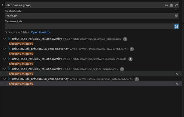

  • Hi Marko,
    I'm glad to hear you found the problem, thank you for the update. Yes, adding the nfct-pins-as-gpios; property to the uicr node is the correct approach for now even though the 54l does not have a register for this in UICR like the 52/53 series did.  We are doing the same in our tests as you can see here:
    The NRF_CONFIG_NFCT_PINS_AS_GPIOS flag will be set when you have the nfct-pins-as-gpios property defined in your devictree ensuring that this line is executed on every boot: https://github.com/zephyrproject-rtos/hal_nordic/blob/54f33f10a0b826174fb145f155afa61ce5a44b93/nrfx/mdk/system_nrf54l.c#L226
    Please refer to the pin assigments chapter of the nRF54l15 datasheet for more details: https://docs.nordicsemi.com/bundle/ps_nrf54L15/page/chapters/pin.html
