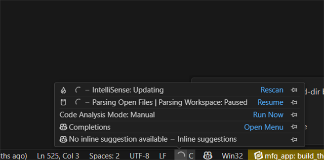

After a recent update, I'm frequently finding the VS Code UI unresponsive due to intelliscan re-indexing.
About my setup.  I have a complex environment with 4 different applications, each application supporting multiple builds for different board build targets and all of the builds are sysbuild based with NCS 2.8.
During a build I select the sysbuild outer context and use the actions UI interface to trigger a west build.
Recently I'm finding that the selected target changes from the one I selected to the first sysbuild app within the first board configuration of the current app I'm building.  This triggers a re-index which for takes 1-3 minutes.  Then we I noticed the change, I switch back to the intended board build context, which again causes an re-scan and index.
During the intelliscan indexing I'm unable to perform basic code cursor navigation, eg up and down arrows or searching for text.
I'm finding I have to go back to using a a basic text editor outside of VS Code just to get work done, since I'm so often left waiting for the VS code to get unstuck.

    Can you please share a screenshot of the popup saying it is re-indexing?

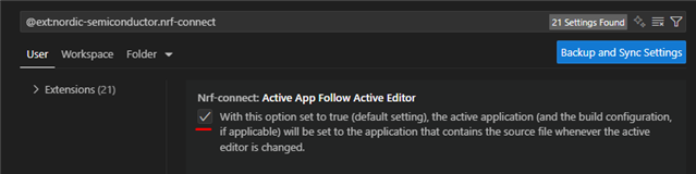

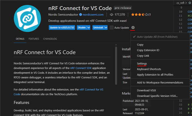

    There is an option to disable the auto-switching of the selected project.
    If you enter the nRF Connect for VS Code extension settings:
    And disable "Active App Follow Active Editor":
    Then it will not keep changing the active build, unless you actively click another build in the "Applications" menu.

    I think your suggestion of disabling this feature will help.
  • I can agree that in many cases, this causes more confusion. I would assume it is common to look at other samples to implement your own application. And either way, if you don't do that, and only work on one application, then automatic switching isn't really necessary either.
    Disabling it should at least stop it from changing the active build on it's own.
