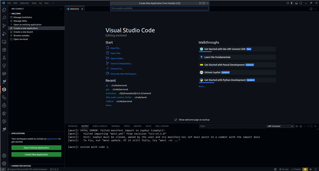

Unable to install SDK via VS Code
I have installed nRF connect 2025.9.732 on my VS code Version: 1.103.2 on Ubuntu 22.04.
I am able to install the toolchains successful but I am getting this weird error message

[west]: usage: west [-h] [-z ZEPHYR_BASE] [-v] [-q] [-V] <command> ...
[west]: west: unknown command "zephyr-export"; workspace /home/akshay/ncs/v3.1.0 does not define this extension command -- try "west help" and "west -vv status"
[west]: exited with code 1.
[west]: FATAL ERROR: failed manifest import in zephyr (zephyr):
[west]:   Failed importing "west.yml" from revision "ncs-v3.1.0"
[west]:   Hint: zephyr must be cloned, owned by the user and its manifest-rev ref must point to a commit with the import data
[west]:   To fix, run "west update. If it still fails, try "west -vv ..."

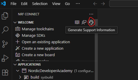

  • Hi Akshay,
    Could you provide the detailed logs for this as well?
    Also, maybe it could be that you have a topdir that shadows these path. Could you open a terminal with any toolchain available and go in the target folder and check topdir:
    $ nrfutil sdk-manager toolchain launch --shell --ncs-version v3.1.1
    $ cd /home/akshay/ncs/v3.1.1
    $ west topdir
    <strong>/home/akshay/ncs/v3.1.1</strong>
    -Priyanka
  • Here is a full debug log for installing the SDK. FYI I had the binaries already downloaded, I uninstalled the SDK and reinstalled it with debug flag, so you may not see anything downloading
    [2025-09-19T07:51:59.513Z] [14744] INFO - [nrfutil_common::logger] nrfutil-sdk-manager (version = 1.6.2, platform = x86_64-unknown-linux-gnu, classification = nrf-external) invoked with install v3.1.1 --log-level debug
