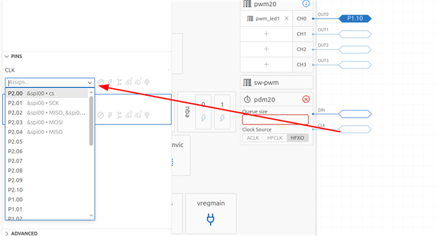

We are developing a schematic for our device and trying to correctly assign GPIOs for different peripherals.
There is the Cross power-domain use section in the documentation, that tells, that we can only use SPIM, SPIS and UARTE
digital interfaces on the P2 port.
However, the Devicetree Visual Editor tool from the VScode extension allows assigning, for example, PDM of I2S on the P2 port.
See the picture below:
Can you, please, confirm if it is a bug in the Visual Editor? Or is it possible to use PDM on the P2 port?
