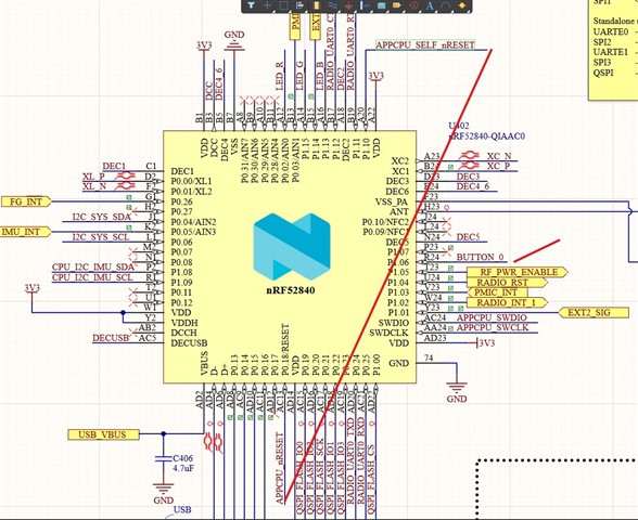

I am trying to use the two GPIO pins. One GPIO pin is configured as a input and connected externally to a button.
The second is configured as an output pin. I want to press the button and trigger the second GPIO pin to output a low signal
The button press will trigger a hardware nRESET. see attached schematics
I use the PPI to connect them, not sure if this is the way to do it. Especially the TEP and EEP register values not sure about

  • Hi Øystein,
    I'm not sure I like the idea of having a GPIO output connected directly to the reset line. Is it not sufficient to perform a soft reset from your code? Anyway, I took the liberty of updating your code to make it more readable, see below. The  TEP or EEP or endpoint address was wrong.

  • Hi Vidar
    I think you are correct, its uneccesary I think to use a GPIO and route it to the nRESET pin. It semmes like it has hostorically been designed that way for firmware upgrade over USB. USBDFU Trigger Lib need a GPIO that can control the physical "RESET pin
    I also encountered a problem with my design. The PPI channel TASK OUT do not release the PIN and set it HIGH, its kept  LOW so the  MCU freezes. It do not work. I also tried to set up a second PPI channel to trigger a LOW_TO_HIGH on the GPIO pin 1.10 when the nRESET signal goes  LOW. Not sure why, but did not work
    Anyway. as you point out, Is it not sufficient to perform a soft reset from your code. I think maybe I try that, but is there any code exapmles or guides on how I can trigger SOFT RESET triggered by a GPIO INTERRUPT event HIGH_TO_LOW on pin GPIO 1.6

  • Hi Øystein,
    Are you testing with the output physically connected to the reset line?

  • Hi
    I dont have any bootloader but solved it like this. With this code i can choose wether to have a software reset or hardware reset

    I am not 100% sure if myt understanding of SOFT and HARD RESET is coreect, but anyway both NVIC_SYSTEMRESET() or setting the P.1.10 LOW both ways will reset the MCU
