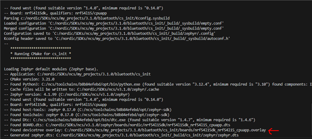

    You are correct. It is recommended to leave everything in the SDK untouched. I prefer to, whenever I want to modify anything in a sample, even, to copy it outside the SDK and then run it from there. Copy the sample folder to a custom location, then clidk "Open an existing application" in VS Code:
    So to your actual question. You are on the right track. You should use an overlay file. There are a couple of different ways to do this. The most common way is to create a file with the board name that you are building for, such as:
    nrf52840dk_nrf52840.overlay
    if this is present in your application folder, or in a folder called "boards" that is present in your application folder (the same folder as the CMakeLists.txt), then the compiler should pick it up (you can verify it from the build log):
    So in this file, you can specify everything you want to behave different from the default dts/dtsi files. So everything you want to change, you copy that block from the dts(i) file, paste it in your overlay file, and modify it there, such as:

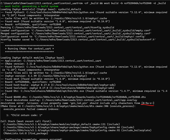

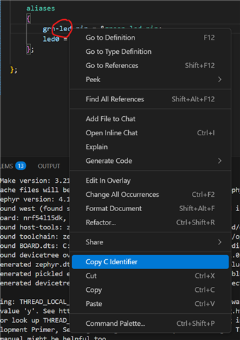

    Having trawled through loads of other people asking similar questions I am completely failing to compile with simple GPIO reassignments for LED driving. I can change the dts file and it works fine, but the overlay file, not a chance. I've tried a zillion different combinations.
    My app.overlay file which was already in the project and seems to be used according to the check above you mentioned:
    chosen {
    nordic,nus-uart = &uart0;
    gpioCustom {
    green_led_pin: green_led_pin {
    gpios = <&gpio1 10 GPIO_ACTIVE_LOW>;
    label = "green_led_pin";
    aliases{
    grn_led_pin = &green_led_pin;
    In main.c
    #define LED_GREEN_NODE DT_ALIAS(grn_led_pin)
    static const struct gpio_dt_spec green_led = GPIO_DT_SPEC_GET(LED_GREEN_NODE, gpios);
    I am down to one error after loads of combinations of things:
        "resource": "/home/robertw/Software/Nordic/custom_service/central_uart/src/main.c",
        "owner": "C/C++: IntelliSense",
        "code": "20",
        "severity": 8,
        "message": "identifier \"__device_dts_ord_DT_N_ALIAS_grn_led_pin_P_gpios_IDX_0_PH_ORD\" is undefined",
        "source": "C/C++",
        "startLineNumber": 55,
        "startColumn": 46,
        "endLineNumber": 55,
        "endColumn": 62
    Or, more succinctly:
    What do I need to do here please?
    It shouldn't be this difficult
    to toggle a pin. :-(

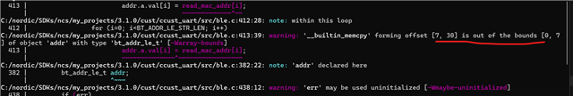

    FYI, I just looked through some of the warnings, such as this one:
    This snippet:
    	get_mac_addr(read_mac_addr);
    	if ((SCAN_FOR_NAME == scan_type) || (true == check_blank_addr(read_mac_addr)))
    		err = bt_scan_filter_add(BT_SCAN_FILTER_TYPE_NAME, DEVICE_NAME);
    		filter_type = SCAN_FOR_NAME;
    		new_pairing = true;
    	else if (SCAN_FOR_ADDR == scan_type)
    		addr.type = BT_ADDR_LE_RANDOM;
    		for (i=0; i<BT_ADDR_LE_STR_LEN; i++)
    			addr.a.val[i] = read_mac_addr[i];
    		err = bt_scan_filter_add(BT_SCAN_FILTER_TYPE_ADDR, &addr);
    		filter_type = SCAN_FOR_ADDR;
    BT_ADDR_LE_STR_LEN = 30, and the add.a.val[i] ony have 6 elements, so you risk corrupting your RAM when writing outside the initial 6 elements in the array. You should definitiely look into this. Use "i < BT_ADDR_SIZE" instead of "BT_ADDR_LE_STR_LEN".
    Please see the attached projec.t I modified the app.overlay, added the sleep configuration for the UART, and also added the "&uicr", which is needed to be able to use the NFC pins as normal GPIOs.

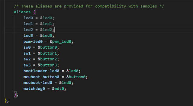

  • I just verified that it worked with the blinking pattern of your 3 LEDs. They blinked faster when P0.29 was connected to GND when I reset the device. So what I did was to redefine button0, as you can see in the app.overlay. If you look in your main.c, you can see that you fetch the switch:
    #define SWITCH_NODE DT_ALIAS(sw0)
    static const struct gpio_dt_spec user_switch = GPIO_DT_SPEC_GET(SWITCH_NODE, gpios);
    using sw0. sw0 is fetched from the aliases list in nrf52840dk_nrf52840.dts:
    You can see the ones that are "greyed out" in this list, those are the ones that are redefined in app.overlay. This also means that you technically still have led3 (although it is not being used in your application. The same goes for sw1-3 that are defined but not used.
    The reason sw0 is not grey is that it is still mapped to button0, but button0 is redefined, so if you scroll up in that same file, you will see that the definition of button0 is greyed out.
