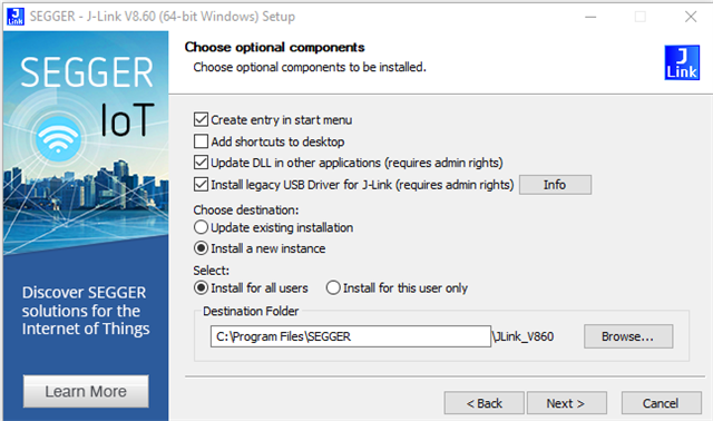

When installing, I chose install legacy driver option

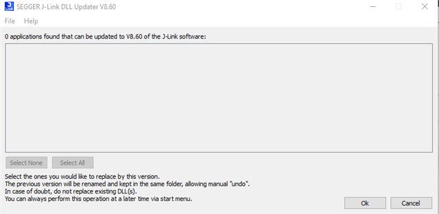

it says no applications to update as shown below

    Can you try to perform installation when "Install legacy USB driver for J-Link" is left unchecked? Do you observe any change?

    I tried with "Install legacy USB driver for J-Link" unchecked as well and result is still same. Development kit is not detected.

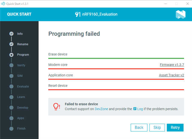

    Following are the screenshot from quick start guide usage and log file
    2025-09-08T15:29:06.187Z INFO Initialising the bundled nrfutil device
    2025-09-08T15:29:06.973Z DEBUG Started watching devices
    2025-09-08T15:29:13.667Z INFO Using the bundled core version for nrfutil device: 8.1.1
    2025-09-08T15:29:13.689Z INFO Using nrfutil-device version: 2.10.2
    2025-09-08T15:29:13.689Z INFO Using nrf-device-lib version: 0.17.71
    2025-09-08T15:29:13.689Z INFO Using nrf-probe version: 0.38.0
    2025-09-08T15:29:13.689Z INFO Using JLink version: JLink_V8.60
    2025-09-08T15:29:13.690Z INFO Your version of SEGGER J-Link (8.60) is newer than the one this app was tested with (8.18). The tested version is not required, and your J-Link version will most likely work fine. If you get issues related to J-Link with your devices, use the tested version.
    2025-09-08T15:29:14.928Z DEBUG Selected device: nRF9160 DK
    2025-09-08T15:29:14.956Z DEBUG Changed step: Info
    2025-09-08T15:30:32.867Z DEBUG Changed step: Rename
    2025-09-08T15:31:09.137Z DEBUG Changed step: Program

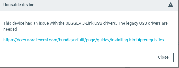

    I tried with programmer and tried to select device and it shows that there are issues with USB drivers.
    Overall, I understand this is due to USB driver issue but not able to resolve, even though I tried to install legacy drivers and multiple versions of segger J link software.
    Can you show the output of "nrfutil device --version"?
    It seems that legacy USB drivers are needed. You can look at prerequisites. You can try to install Segger USB driver for J-Link manually from command line using the command
    JLink_Windows_V860_x86_64.exe -InstUSBDriver=1
