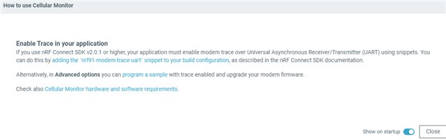

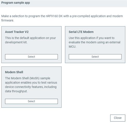

    In the meantime, I am also testing with the nRF9160 DK to check if the same issue occurs. Could you please guide me on which sample application is best suited to reproduce and root cause this?
    I am also trying to use the Cellular Monitor application, but it seems to hang indefinitely. Is there a recommended or compatible application that I should load on the DK for Cellular Monitor to work? I assume the application should enable CONFIG_NRF_MODEM_LIB_TRACE=y, but I’m not sure which sample does this out of the box.
    If Cellular Monitor is not suitable, could you suggest any other way to capture modem traces?
    It is unexpected that Cellular Monitor just hangs. Can you provide some details about this? You should be able to open Cellular Monitor and connect to your board regardless of the firmware that is running on your board.
    Regarding modem trace, here are some links for your reference
    Cellular Monitor overview
    Cellular Monitor requirements
    nRF modem tracing using snippets
    capturing modem trace
    Here is information from Cellular Monitor itself
    and here is what is available from Cellular Monitor's Advanced Options
