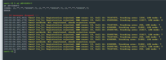

I was busy extending the asset tracker project and all of a sudden I got this lte rejection.
First I thought maybe it the data limit has reached on the conexa sim, but when I place a new omondo sim in it, I get similar EMM Causes.
What could be the issue here?
I moved the DK closer to the window and also tried to connect an antenna to it, but still no luck.
