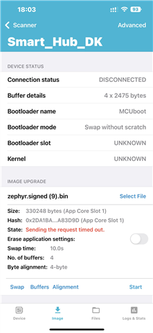

    I used the nRF Connect Device Manager app to download my code, but encountered an error: "Request sending timed out." Why is this so?
    This is the prj.conf file:

    This is the sysbuild.conf file:
    SB_CONFIG_BOOTLOADER_MCUBOOT=y
    What should I do?
    Thanks.
    Yes. I can now perform OTA using the RF Connect Device Manager App. However, when the prj.conf file has CONFIG_BT_CTLR_PHY_CODED=y, it will result in "Request sending timed out". Is it because my phone (my phone model is iPhone 13 Pro Max) does not support PHY code?
    Thanks.

    This problem still exists. However, after analysis, we believe that this is related to whether the mobile phone supports PHY_CODED. If PHY_CODED is turned off, then the update will succeed. Now we no longer pay attention to this issue. The main problem is how the hub sets the secondary slot 1 and secondary slot 2 in the off-chip flash. Secondary slot 1 is used for the update of the hub itself, while secondary slot 2 is used to receive the firmware of the terminals connected to the hub.
