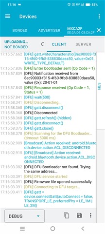

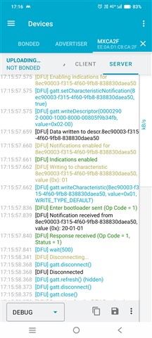

  3. While DFU from NRFConnect app is triggered, the Enter bootloader command is sent. "Enter bootloader sent (Op Code = 1)".
  4. Response received from device is "Response received (Op Code = 1, Status = 1)".
  5. But later in the NRF logs it shows "DFU Bootloader not found. trying the same address..".
  6. When we try to connect to bootloader directly when it advertises in DFU mode, the connection attempt is failing every time and Error Code for disconnection is 255(0xFF).

    2. NRF does increment the address value by 1 and I am able to see the bootloader application advertising in NRF connect app after the DFU process is triggered. But the application fails to connect to bootloader during this DFU process. Also, when tried to connect directly to the bootloader app since it is advertising, the connection event again fails. Another observation is that the bootloader app does not advertise frequently. Sometimes it advertises and then stops advertising for some time and starts again.
    3. While entering bootloader mode during DFU, the NRF logs I received are pasted:
