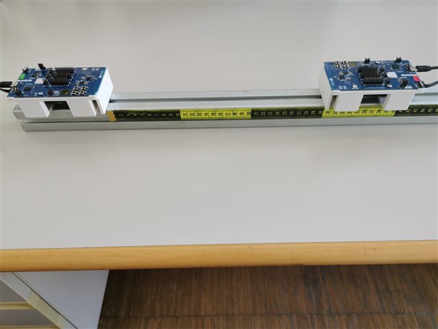

  • Hello Simon.
    We built a measurement station such that the devices will stay in place during measurements. (See picture)
    The measurements took place in a “normal” indoor/office environment, I would say.

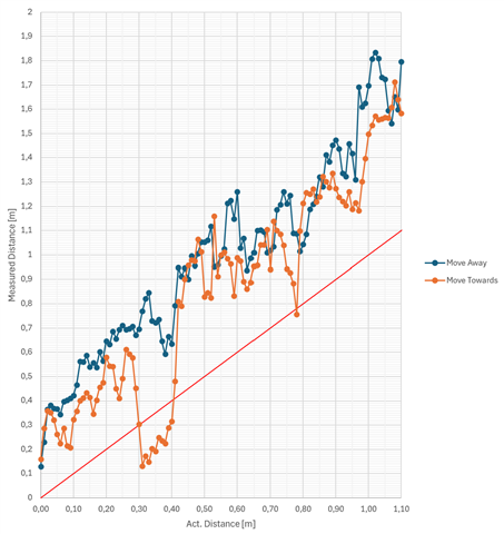

    I have also detected that even with a constant movement away from each other, the devices sometimes detect movements closer to each other. (See diagramm) Do you have any idea why this is happening?

    Also the measurement station you have constructed puts a metal bar pretty close to the antenna, which might affect the measurements you're seeing. When doing channel sounding some false measurements like the ones dropping closer even though the actual distance increases must be expected since there might be noise or a packet loss occurring, so if you need more filtered measurements you can sample a few of them and take the best estimate based on a couple of them.
    I don't have the details on what was used in the demo I'm afraid as that was built on an older NCS version and older channel sounding algorithm than what is in NCS 3.x.x. In the end, you can't expect much better than 0.5m measurements I'm afraid.
