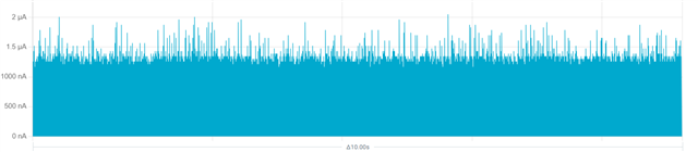

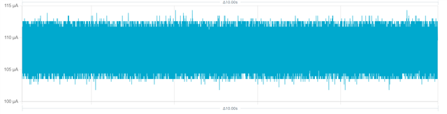

    On my end:
    Current draw on P0.17 with HWFC
    Without HWFC

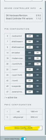

    Turn off HWFC here

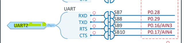

    • A more important question: in which official document or specification could I find information that P0.17 (and P0.16) are used for this purpose? Additionally, is it possible to obtain the complete schematic of the DK board? The available documentation only shows partial schematics, but I haven’t found the full board diagram
  • Hi, if you want to make the debugger stop controlling the HWFC pins, then that needs to be done either by the board configurator or using nrf-util. The nRF9151 itself doesn't have any control over the debugger.
    However, on your custom board/final product, this wouldn't be an issue because it will not have a debugger connected with UART and HWFC in the first place.
    Nevertheless, if you intend to have the DK in your final product or if you need to do this to multiple boards, you can use nrf-util to automate the process.
    You just need to create a json file with the configs like this
        "operations": [
                "operation":{
                    "type": "smp",
                    "operation":2,
                    "group_id":64,
                    "command_id":0,
                    "sequence_number":0,
                    "data": [[6,false,7,false,8,false,14,true,18,true,20,true,22,false,23,false,42,false,45,false,47,false],[1,1800,2,3000]]
                "operationId":"1"
    Using the board configurator app and then click on Show Config JSON, you can copy the output and put it in the data field above.
    Then run nrfutil device x-execute-batch --traits boardController --batch-path "PATH TO YOUR JSON"

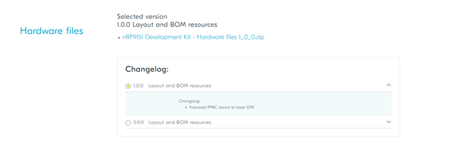

    As for the hardware files, you can download it here
    nRF9151 DK - Downloads - nordicsemi.com
    In the schematic included in that zip file, you can see that P0.17 is also connected to CTS
