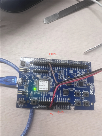

Recently, I have been working on development in NCS. I attempted to drive the WS2812B LED lights, but they failed to light up so far. I would like to ask you to check if there are any issues with the parameters and configurations. I successfully implemented the normal operation of the nrf52832 development board and the ws2812b LED driver in SDK 17.1.Therefore, I can confirm that my hardware is functioning properly.

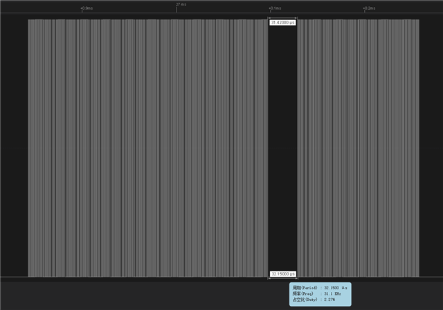

  • Hi Vidar
    static const struct led_rgb colors[] = {
        RGB(0xFF, 0x00, 0x00), /* red */
    #define SPI_FREQ    8000000 //  1 freq : 125ns
    #define ZERO_FRAME  0x03    //  0000 0011   (ws2812b code1: 250ns h + 750us l)
    #define ONE_FRAME   0x3F    // 0011 1111   (ws2812b code0: 750ns h + 250us l)

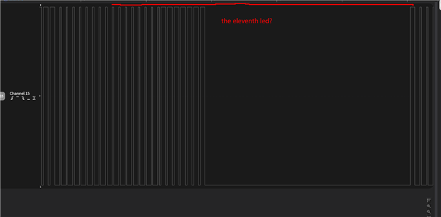

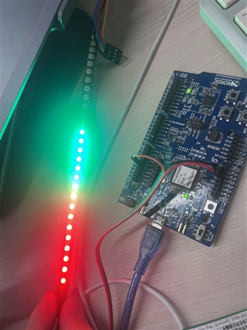

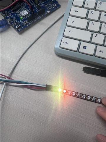

    I captured the waveform of MOSI using the logic analyzer. It corresponds to colors.
    But why are not all the light strips connected to my development board red? What's the reason for this?
    I have attached the photos of the abnormal light strips and the waveforms traced by the logic analyzer.
    Best regard

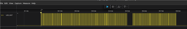

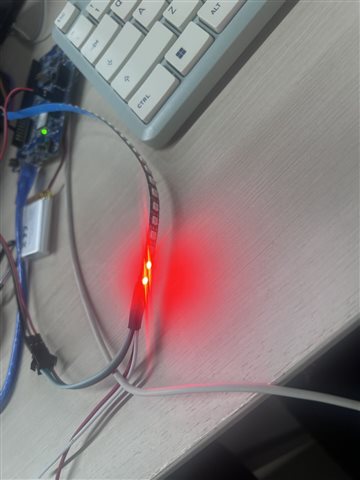

    I attempted to light only two of the light bulbs, and made some modifications to ZERO_FRAME and ONE_FRAME. I discovered that the color of the first light bulb was incorrect. I checked the waveform and it seemed that it did not follow the budgeted plan.Two strange waveforms appeared at the very beginning and the very end.
    Best regard
    It's been a while since I tried to use neopixels, so I don't remember the details of how it really worked and if the pause at the beginning and end is a problem or not. Could you please compare the difference between the wafeform generated from your SDK 17 project to see what the differences are?

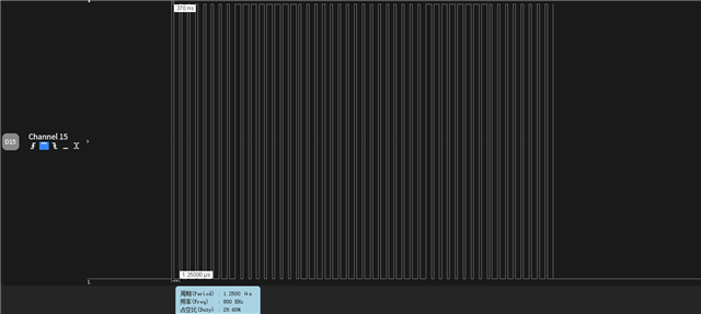

  • Hi Vidar
    PWM Specific parameters in SDK17.1 are
    #define WS2812_T1H                  14 | 0x8000   //code1: 875ns H + 375ns L
    #define WS2812_T0H                  6  | 0x8000   //code0: 375ns H + 875ns L
    static uint32_t pwm_init(void)
        nrfx_pwm_config_t pwm_config = NRFX_PWM_DEFAULT_CONFIG;
        pwm_config.output_pins[0] = NRFX_PWM_PIN_NOT_USED;
        pwm_config.output_pins[1] = WS2812_PIN;
        pwm_config.output_pins[2] = NRFX_PWM_PIN_NOT_USED;
        pwm_config.output_pins[3] = NRFX_PWM_PIN_NOT_USED;
        pwm_config.load_mode    = NRF_PWM_LOAD_INDIVIDUAL;
        // WS2812 protocol requires a 800 kHz PWM frequency. PWM Top value = 20 and Base Clock = 16 MHz achieves this
        pwm_config.top_value    = 20;
        pwm_config.base_clock   = NRF_PWM_CLK_16MHz;
        return nrfx_pwm_init(&m_pwm0, &pwm_config, pwm_handler);

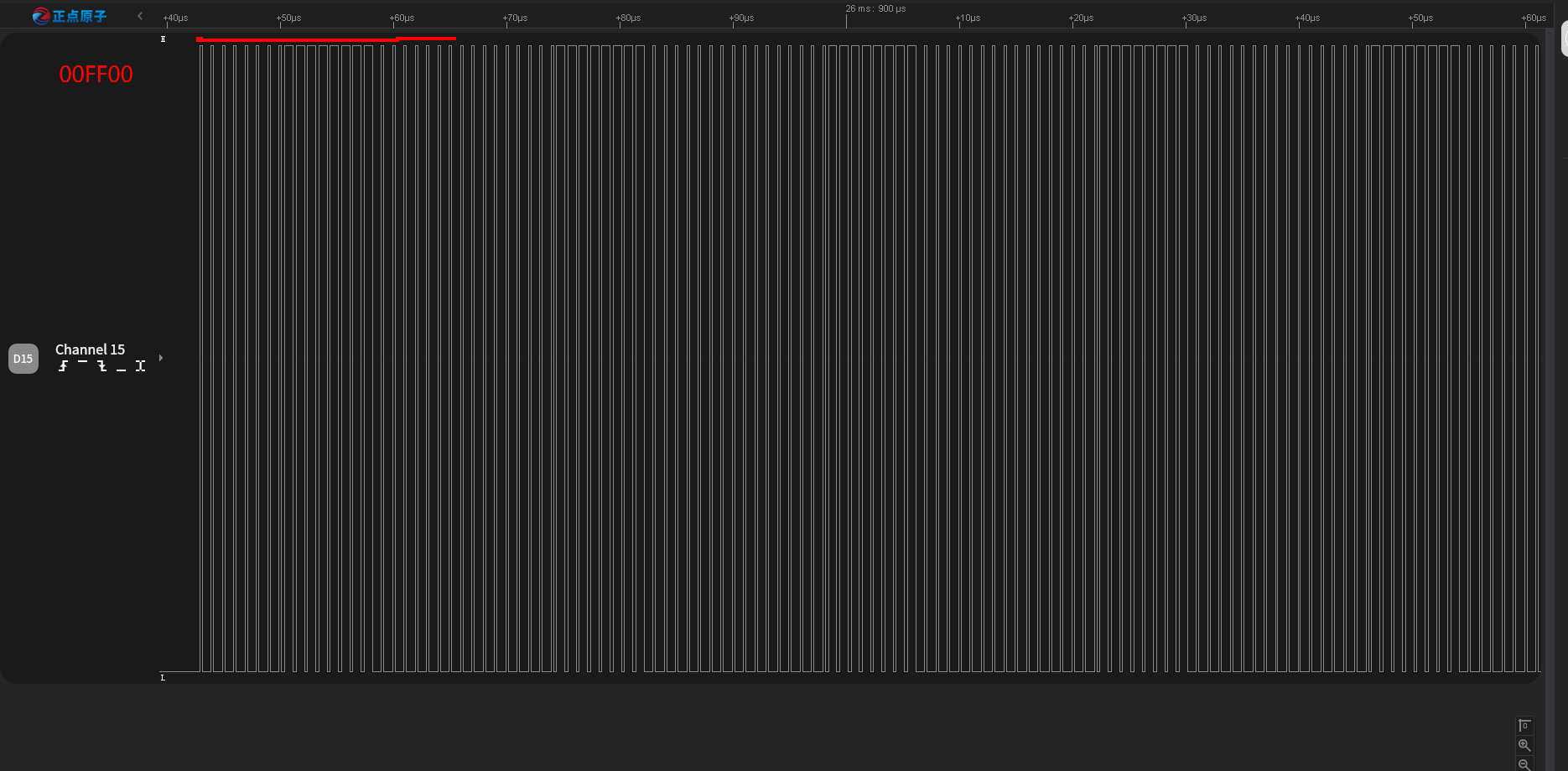

    Below is the waveform I debugged using SDK17's PWM. It involves two light bulbs, and the output is 0XFF0000.A very standard waveform!

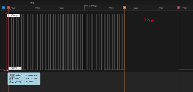

    I tried the LED strip sample (zephyr/samples/drivers/led/led_strip/) from SDK v3.1.1 with nrf52dk/nrf52832 as the build target. I did not make any changes to the sample, but I do not see the inverted signal at the end of the transfer as you did.
    4064.led_strip_nrf52832.hex
    Did you see the inverted signal before you made your changes?
  • Hi vidar
    i'm sorry to reply late.
    You are correct!The original values in the sample can function properly. However, if you set the following parameters, it will produce incorrect waveforms. You can give it a try.I don't understand why ZERO FRAME or ONE FRAME would give an error when the highest bit set 1.
