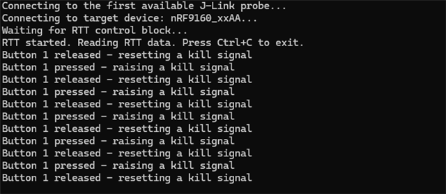

  • Seems like the issue was with the python script itself. I did some changes and now it works fine;

  • Wow, that's great. I guess the use of the if statement was misguided.
    Thanks much, that will get me going.
