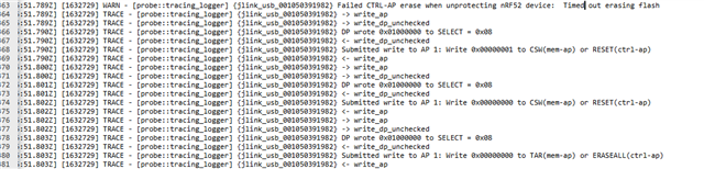

Recovery of nrf52dk fails due to access port protection
Hello. I have an issue with my development board. When attempting to recover the board, i cannot due to access port protection. This is the specific error message from the programmer:
Failed "recovering application core". Error: code: 1, description: Generic, message: Batch task recover failed, Device error: Access Port is still protected after Erase and Reset
Attempting to do it manually with JLink commander also fails. The error seems to have appeared after programming it with a blank project(was working fine previously)
Attached is nrfutil-device log:

    Could you check whether your DK has been powered properly and let me know what application is currently running on it?
    Also, what version of nrfutil are you using? You could try updating nrfutil to see if that resolves the issue.
    Lastly, have you tried recovering the device?
    Abhijith
  • The DK is powered via USB cable and nothing indicates it is not powered properly. The application on it is just a blank project.
    nrfutil is the latest version
    The described issue occurs when attempting to recover the device
    Sorry for getting back to you a bit late. I hope you have tried "nrfutil device recover --serial-number <your-dk-serial-number>".
    From the shared log, it looks like it’s timing out while erasing the flash. Please check if the DK COM port is open somewhere else, maybe in VS Code if you’re using it for development. Also, try running "nrfjprog --recover" to see if that resolves the issue.
    I’m not sure what you mean by "blank project" here ,is this one of the SDK samples?
    Abhijith
  • Attempting recovery with the serial number specified produces the same result
    lsof doesnt list anything else as using the port(I am on Ubuntu 22.04 btw)
    nrfjprog --recover produces this, which is the same error as earlier:
    [error] [ Client] - Encountered error -21: Command recover executed for 30180 milliseconds with result -21
    [error] [ Worker] - Encountered error while performing post-recover cleanup. -90: Access protection is enabled, can't read device version.
    ERROR: Recover failed. Please make sure that the correct device family is given
    ERROR: and try again.
    specifying the family as NRF52 doesnt change anything
    By blank project I mean a blank application as selected in vscode when you start a new project. It is just an empty int main()
    Try flashing another basic sample from the SDK into the DK. If you are flashing via VS Code, you should get a prompt to remove the AP protect when you try to flash.
