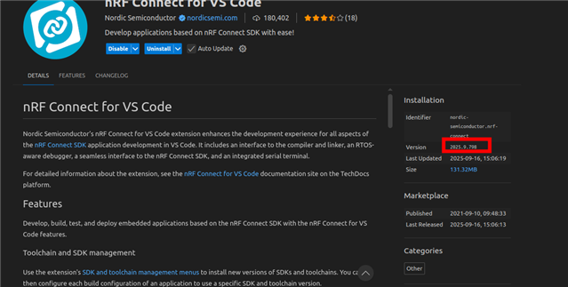

  • I was able to flash by rolling back the extension to the previous version, 2025.9.732.
  • We published a new release just now (Build number: 2025.9.789) which addresses this.
  • Thanks for the quick response. I updated the extension but it still fails to recover the board.
    [13:43:59] nrfutil-device recover --serial-number 001050261677 --json
    [13:44:00] Error: One or more recover tasks failed:
    * 1050261677: Unable to find worker executable: Custom { kind: NotFound, error: "Failed to find file plugin-probe-worker. Looked for file in <none>, <none>, /home/vsts/.cargo/registry/src/eu.files.nordicsemi.com-aeee3781a8ecf169/target/release/plugin-probe-worker and /home/developer/.vscode/extensions/nordic-semiconductor.nrf-connect-2025.9.789-linux-x64/platform/nrfutil/bin/plugin-probe-worker" } (Generic)
    The extension expects the plugin-probe-worker worker in:
    But
    $ locate plugin-probe-worker
    /home/developer/.config/nrfconnect/nrfutil-sandboxes/device/2.10.2/lib/nrfutil-device/plugin-probe-worker
    /home/developer/.vscode/extensions/nordic-semiconductor.nrf-connect-2025.9.789-linux-x64/platform/nrfutil/lib/nrfutil-device/plugin-probe-worker
    bin != lib/nrf-util-device (yes, I updated the locate db).
    Any ideas?
