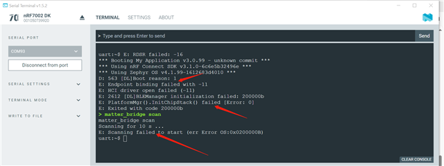

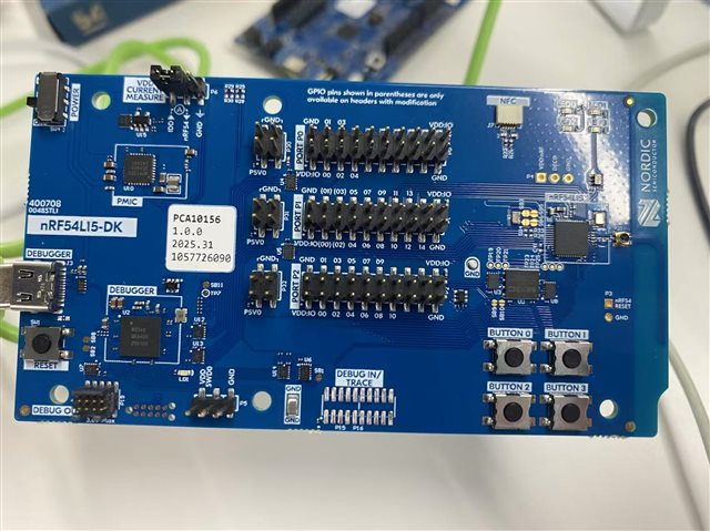

I tested matter bridge sample running on the nRF7002DK with peripheral_lbs sample running on the nRF54L15DK.
Then I encountered problems like the following screenshot.

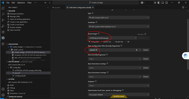

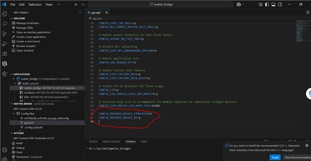

I just add the following Kconfig options to the project.
Hi Support Team

By the way, in addition to my previous comment, what change you made on the config file? I can't open the screenshot.

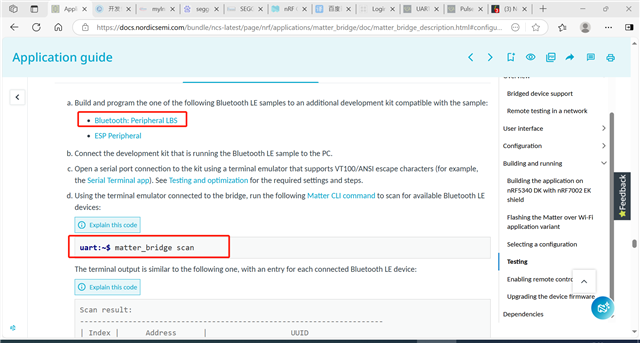

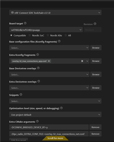

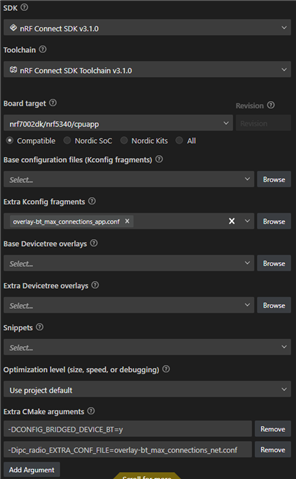

Please refer to the command in the Bridged device configuration:
The VS Code build configuration looks like this:

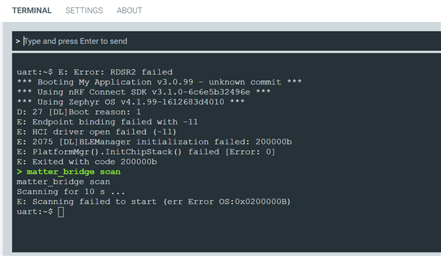

I set the VS Code build configuration for the matter bridge sample as per your suggestions, but it still fails to run.
Try to delete the build folder and build the project again.
E: No valid legacy adv E: No valid legacy adv D: 36381 [DL]Write request received for CHIPoBLE RX characteristic (ConnId 0x00) I: 36388 [BLE]local and remote recv window sizes = 5 I: 36393 [BLE]selected BTP version 4 I: 36396 [BLE]using BTP fragment sizes rx 77 / tx 77. D: 36502 [DL]ConnId: 0x00, New CCCD value: 0x0002 D: 36506 [DL]Sending indication for CHIPoBLE TX characteristic (ConnId 00, len 6) D: 36514 [IN]BLE EndPoint 0x2000e5b8 Connection Complete D: 36561 [DL]Indication for CHIPoBLE TX characteristic done (ConnId 0x00, result 0x00) D: 36569 [DL]Write request received for CHIPoBLE RX characteristic (ConnId 0x00) D: 36651 [DL]Write request received for CHIPoBLE RX characteristic (ConnId 0x00) I: 36659 [EM]>>> [E:25609r S:0 M:137832687] (U) Msg RX from 0:AA236985CCF67CB7 [0000] to 0000000000000000 --- Type 0000:20 (SecureChannel:PBKDFParamRequest) (B:98) I: 36674 [EM]<<< [E:25609r S:0 M:70831690] (U) Msg TX from 0000000000000000 to 0:AA236985CCF67CB7 [0000] [BLE] --- Type 0000:21 (SecureChannel:PBKDFParamResponse) (B:154) D: 36689 [DL]Sending indication for CHIPoBLE TX characteristic (ConnId 00, len 77) I: 36697 [SVR]Commissioning session establishment step started D: 36741 [DL]Indication for CHIPoBLE TX characteristic done (ConnId 0x00, result 0x00) D: 36749 [DL]Sending indication for CHIPoBLE TX characteristic (ConnId 00, len 77) D: 36801 [DL]Indication for CHIPoBLE TX characteristic done (ConnId 0x00, result 0x00) D: 36809 [DL]Sending indication for CHIPoBLE TX characteristic (ConnId 00, len 9) D: 36891 [DL]Indication for CHIPoBLE TX characteristic done (ConnId 0x00, result 0x00) D: 36899 [DL]Write request received for CHIPoBLE RX characteristic (ConnId 0x00) D: 37011 [DL]Write request received for CHIPoBLE RX characteristic (ConnId 0x00) I: 37019 [EM]>>> [E:25609r S:0 M:137832688] (U) Msg RX from 0:AA236985CCF67CB7 [0000] to 0000000000000000 --- Type 0000:22 (SecureChannel:PASE_Pake1) (B:92) I: 38438 [EM]<<< [E:25609r S:0 M:70831691] (U) Msg TX from 0000000000000000 to 0:AA236985CCF67CB7 [0000] [BLE] --- Type 0000:23 (SecureChannel:PASE_Pake2) (B:127) D: 38452 [DL]Sending indication for CHIPoBLE TX characteristic (ConnId 00, len 77) E: 38460 [DL]Long dispatch time: 1449 ms, for event type 16388 D: 38571 [DL]Indication for CHIPoBLE TX characteristic done (ConnId 0x00, result 0x00) D: 38579 [DL]Sending indication for CHIPoBLE TX characteristic (ConnId 00, len 57) D: 38691 [DL]Indication for CHIPoBLE TX characteristic done (ConnId 0x00, result 0x00) D: 38699 [DL]Write request received for CHIPoBLE RX characteristic (ConnId 0x00) I: 38707 [EM]>>> [E:25609r S:0 M:137832689] (U) Msg RX from 0:AA236985CCF67CB7 [0000] to 0000000000000000 --- Type 0000:24 (SecureChannel:PASE_Pake3) (B:59) I: 38721 [EM]<<< [E:25609r S:0 M:70831692] (U) Msg TX from 0000000000000000 to 0:AA236985CCF67CB7 [0000] [BLE] --- Type 0000:40 (SecureChannel:StatusReport) (B:30) D: 38736 [DL]Sending indication for CHIPoBLE TX characteristic (ConnId 00, len 35) D: 38745 [IN]SecureSession[0x200065e0]: Activated - Type:1 LSID:31188 D: 38752 [IN]New secure session activated for device <FFFFFFFB00000000, 0>, LSID:31188 PSID:35348! I: 38760 [SVR]Commissioning completed session establishment step I: 38766 [DIS]Updating services using commissioning mode 0 I: 38772 [DIS]CHIP minimal mDNS started advertising. D: 38777 [DL]CHIPoBLE advertising set to off I: 38781 [SVR]Device completed Rendezvous process D: 38811 [DL]Indication for CHIPoBLE TX characteristic done (ConnId 0x00, result 0x00) D: 38819 [DL]Write request received for CHIPoBLE RX characteristic (ConnId 0x00) I: 38828 [EM]>>> [E:25610r S:31188 M:239398838] (S) Msg RX from 0:FFFFFFFB00000000 [0000] to 0000000000000000 --- Type 0001:02 (IM:ReadRequest) (B:51) I: 38845 [EM]<<< [E:25610r S:31188 M:78179857] (S) Msg TX from 0000000000000000 to 0:FFFFFFFB00000000 [0000] [BLE] --- Type 0001:05 (IM:ReportData) (B:68) D: 38858 [DL]Sending indication for CHIPoBLE TX characteristic (ConnId 00, len 73) D: 38931 [DL]Indication for CHIPoBLE TX characteristic done (ConnId 0x00, result 0x00) D: 38939 [DL]Write request received for CHIPoBLE RX characteristic (ConnId 0x00) I: 38948 [EM]>>> [E:25611r S:31188 M:239398839] (S) Msg RX from 0:FFFFFFFB00000000 [0000] to 0000000000000000 --- Type 0001:02 (IM:ReadRequest) (B:51) I: 38965 [EM]<<< [E:25611r S:31188 M:78179858] (S) Msg TX from 0000000000000000 to 0:FFFFFFFB00000000 [0000] [BLE] --- Type 0001:05 (IM:ReportData) (B:92) D: 38979 [DL]Sending indication for CHIPoBLE TX characteristic (ConnId 00, len 77) D: 39051 [DL]Indication for CHIPoBLE TX characteristic done (ConnId 0x00, result 0x00) D: 39059 [DL]Sending indication for CHIPoBLE TX characteristic (ConnId 00, len 22) D: 39171 [DL]Indication for CHIPoBLE TX characteristic done (ConnId 0x00, result 0x00) D: 39179 [DL]Write request received for CHIPoBLE RX characteristic (ConnId 0x00) I: 39188 [EM]>>> [E:25612r S:31188 M:239398840] (S) Msg RX from 0:FFFFFFFB00000000 [0000] to 0000000000000000 --- Type 0001:02 (IM:ReadRequest) (B:52) I: 39205 [EM]<<< [E:25612r S:31188 M:78179859] (S) Msg TX from 0000000000000000 to 0:FFFFFFFB00000000 [0000] [BLE] --- Type 0001:05 (IM:ReportData) (B:67) D: 39218 [DL]Sending indication for CHIPoBLE TX characteristic (ConnId 00, len 72) D: 39291 [DL]Indication for CHIPoBLE TX characteristic done (ConnId 0x00, result 0x00) D: 39299 [DL]Write request received for CHIPoBLE RX characteristic (ConnId 0x00) I: 39308 [EM]>>> [E:25613r S:31188 M:239398841] (S) Msg RX from 0:FFFFFFFB00000000 [0000] to 0000000000000000 --- Type 0001:02 (IM:ReadRequest) (B:51) I: 39325 [EM]<<< [E:25613r S:31188 M:78179860] (S) Msg TX from 0000000000000000 to 0:FFFFFFFB00000000 [0000] [BLE] --- Type 0001:05 (IM:ReportData) (B:66) D: 39338 [DL]Sending indication for CHIPoBLE TX characteristic (ConnId 00, len 71) D: 39411 [DL]Indication for CHIPoBLE TX characteristic done (ConnId 0x00, result 0x00) D: 39419 [DL]Write request received for CHIPoBLE RX characteristic (ConnId 0x00) I: 39428 [EM]>>> [E:25614r S:31188 M:239398842] (S) Msg RX from 0:FFFFFFFB00000000 [0000] to 0000000000000000 --- Type 0001:08 (IM:InvokeCommandRequest) (B:59) E: 39443 [DL]Scan request failed I: 39448 [EM]<<< [E:25614r S:31188 M:78179861] (S) Msg TX from 0000000000000000 to 0:FFFFFFFB00000000 [0000] [BLE] --- Type 0001:09 (IM:InvokeCommandResponse) (B:66) D: 39462 [DL]Sending indication for CHIPoBLE TX characteristic (ConnId 00, len 71) D: 39531 [DL]Indication for CHIPoBLE TX characteristic done (ConnId 0x00, result 0x00) D: 39652 [DL]Write request received for CHIPoBLE RX characteristic (ConnId 0x00) I: 39660 [EM]>>> [E:25615r S:31188 M:239398843] (S) Msg RX from 0:FFFFFFFB00000000 [0000] to 0000000000000000 --- Type 0001:02 (IM:ReadRequest) (B:51) I: 39677 [EM]<<< [E:25615r S:31188 M:78179862] (S) Msg TX from 0000000000000000 to 0:FFFFFFFB00000000 [0000] [BLE] --- Type 0001:05 (IM:ReportData) (B:66) D: 39690 [DL]Sending indication for CHIPoBLE TX characteristic (ConnId 00, len 71) D: 39771 [DL]Indication for CHIPoBLE TX characteristic done (ConnId 0x00, result 0x00) D: 39779 [DL]Write request received for CHIPoBLE RX characteristic (ConnId 0x00) I: 39788 [EM]>>> [E:25616r S:31188 M:239398844] (S) Msg RX from 0:FFFFFFFB00000000 [0000] to 0000000000000000 --- Type 0001:02 (IM:ReadRequest) (B:52) I: 39805 [EM]<<< [E:25616r S:31188 M:78179863] (S) Msg TX from 0000000000000000 to 0:FFFFFFFB00000000 [0000] [BLE] --- Type 0001:05 (IM:ReportData) (B:67) D: 39818 [DL]Sending indication for CHIPoBLE TX characteristic (ConnId 00, len 72) D: 39891 [DL]Indication for CHIPoBLE TX characteristic done (ConnId 0x00, result 0x00) D: 39899 [DL]Write request received for CHIPoBLE RX characteristic (ConnId 0x00) D: 40012 [DL]Write request received for CHIPoBLE RX characteristic (ConnId 0x00) I: 40021 [EM]>>> [E:25617r S:31188 M:239398845] (S) Msg RX from 0:FFFFFFFB00000000 [0000] to 0000000000000000 --- Type 0001:02 (IM:ReadRequest) (B:134) I: 40053 [EM]<<< [E:25617r S:31188 M:78179864] (S) Msg TX from 0000000000000000 to 0:FFFFFFFB00000000 [0000] [BLE] --- Type 0001:05 (IM:ReportData) (B:257) D: 40066 [DL]Sending indication for CHIPoBLE TX characteristic (ConnId 00, len 77) D: 40191 [DL]Indication for CHIPoBLE TX characteristic done (ConnId 0x00, result 0x00) D: 40199 [DL]Sending indication for CHIPoBLE TX characteristic (ConnId 00, len 77) D: 40311 [DL]Indication for CHIPoBLE TX characteristic done (ConnId 0x00, result 0x00) D: 40319 [DL]Sending indication for CHIPoBLE TX characteristic (ConnId 00, len 77) D: 40431 [DL]Indication for CHIPoBLE TX characteristic done (ConnId 0x00, result 0x00) D: 40439 [DL]Sending indication for CHIPoBLE TX characteristic (ConnId 00, len 37) D: 40552 [DL]Indication for CHIPoBLE TX characteristic done (ConnId 0x00, result 0x00) D: 40559 [DL]Write request received for CHIPoBLE RX characteristic (ConnId 0x00) D: 40672 [DL]Write request received for CHIPoBLE RX characteristic (ConnId 0x00) D: 40792 [DL]Write request received for CHIPoBLE RX characteristic (ConnId 0x00) I: 40801 [EM]>>> [E:25618r S:31188 M:239398846] (S) Msg RX from 0:FFFFFFFB00000000 [0000] to 0000000000000000 --- Type 0001:02 (IM:ReadRequest) (B:119) E: 40821 [DMG]Read request on unknown cluster - no data version available E: 40828 [DMG]Fail to retrieve data, roll back and encode status on clusterId: 0x0000_0046, attributeId: 0x0000_0002err = 5c3 E: 40839 [DMG]Read request on unknown cluster - no data version available E: 40846 [DMG]Fail to retrieve data, roll back and encode status on clusterId: 0x0000_0046, attributeId: 0x0000_0001err = 5c3 E: 40858 [DMG]Read request on unknown cluster - no data version available E: 40864 [DMG]Fail to retrieve data, roll back and encode status on clusterId: 0x0000_0046, attributeId: 0x0000_0000err = 5c3 E: 40876 [DMG]Read request on unknown cluster - no data version available E: 40882 [DMG]Fail to retrieve data, roll back and encode status on clusterId: 0x0000_0046, attributeId: 0x0000_0007err = 5c3 E: 40894 [DMG]Read request on unknown cluster - no data version available E: 40901 [DMG]Fail to retrieve data, roll back and encode status on clusterId: 0x0000_0046, attributeId: 0x0000_0006err = 5c3 I: 40918 [EM]<<< [E:25618r S:31188 M:78179865] (S) Msg TX from 0000000000000000 to 0:FFFFFFFB00000000 [0000] [BLE] --- Type 0001:05 (IM:ReportData) (B:311) D: 40932 [DL]Sending indication for CHIPoBLE TX characteristic (ConnId 00, len 77) D: 41031 [DL]Indication for CHIPoBLE TX characteristic done (ConnId 0x00, result 0x00) D: 41039 [DL]Sending indication for CHIPoBLE TX characteristic (ConnId 00, len 77) D: 41151 [DL]Indication for CHIPoBLE TX characteristic done (ConnId 0x00, result 0x00) D: 41159 [DL]Sending indication for CHIPoBLE TX characteristic (ConnId 00, len 77) D: 41271 [DL]Indication for CHIPoBLE TX characteristic done (ConnId 0x00, result 0x00) D: 41279 [DL]Sending indication for CHIPoBLE TX characteristic (ConnId 00, len 77) D: 41392 [DL]Indication for CHIPoBLE TX characteristic done (ConnId 0x00, result 0x00) D: 41399 [DL]Write request received for CHIPoBLE RX characteristic (ConnId 0x00) D: 41406 [DL]Sending indication for CHIPoBLE TX characteristic (ConnId 00, len 16) D: 41511 [DL]Indication for CHIPoBLE TX characteristic done (ConnId 0x00, result 0x00) D: 41519 [DL]Write request received for CHIPoBLE RX characteristic (ConnId 0x00) I: 41528 [EM]>>> [E:25619r S:31188 M:239398847] (S) Msg RX from 0:FFFFFFFB00000000 [0000] to 0000000000000000 --- Type 0001:08 (IM:InvokeCommandRequest) (B:65) I: 41543 [FS]GeneralCommissioning: Received ArmFailSafe (60s) I: 41550 [EM]<<< [E:25619r S:31188 M:78179866] (S) Msg TX from 0000000000000000 to 0:FFFFFFFB00000000 [0000] [BLE] --- Type 0001:09 (IM:InvokeCommandResponse) (B:66) D: 41565 [DL]Sending indication for CHIPoBLE TX characteristic (ConnId 00, len 71) D: 41691 [DL]Indication for CHIPoBLE TX characteristic done (ConnId 0x00, result 0x00) D: 41699 [DL]Write request received for CHIPoBLE RX characteristic (ConnId 0x00) I: 41708 [EM]>>> [E:25620r S:31188 M:239398848] (S) Msg RX from 0:FFFFFFFB00000000 [0000] to 0000000000000000 --- Type 0001:08 (IM:InvokeCommandRequest) (B:70) I: 41726 [EM]<<< [E:25620r S:31188 M:78179867] (S) Msg TX from 0000000000000000 to 0:FFFFFFFB00000000 [0000] [BLE] --- Type 0001:09 (IM:InvokeCommandResponse) (B:66) D: 41740 [DL]Sending indication for CHIPoBLE TX characteristic (ConnId 00, len 71) D: 41811 [DL]Indication for CHIPoBLE TX characteristic done (ConnId 0x00, result 0x00) D: 41819 [DL]Write request received for CHIPoBLE RX characteristic (ConnId 0x00) I: 41828 [EM]>>> [E:25621r S:31188 M:239398849] (S) Msg RX from 0:FFFFFFFB00000000 [0000] to 0000000000000000 --- Type 0001:08 (IM:InvokeCommandRequest) (B:62) I: 41851 [EM]<<< [E:25621r S:31188 M:78179868] (S) Msg TX from 0000000000000000 to 0:FFFFFFFB00000000 [0000] [BLE] --- Type 0001:09 (IM:InvokeCommandResponse) (B:527) D: 41866 [DL]Sending indication for CHIPoBLE TX characteristic (ConnId 00, len 77) D: 41991 [DL]Indication for CHIPoBLE TX characteristic done (ConnId 0x00, result 0x00) D: 41999 [DL]Sending indication for CHIPoBLE TX characteristic (ConnId 00, len 77) D: 42111 [DL]Indication for CHIPoBLE TX characteristic done (ConnId 0x00, result 0x00) D: 42119 [DL]Sending indication for CHIPoBLE TX characteristic (ConnId 00, len 77) D: 42231 [DL]Indication for CHIPoBLE TX characteristic done (ConnId 0x00, result 0x00) D: 42239 [DL]Sending indication for CHIPoBLE TX characteristic (ConnId 00, len 77) D: 42352 [DL]Indication for CHIPoBLE TX characteristic done (ConnId 0x00, result 0x00) D: 42359 [DL]Write request received for CHIPoBLE RX characteristic (ConnId 0x00) D: 42366 [DL]Sending indication for CHIPoBLE TX characteristic (ConnId 00, len 77) D: 42471 [DL]Indication for CHIPoBLE TX characteristic done (ConnId 0x00, result 0x00) D: 42479 [DL]Sending indication for CHIPoBLE TX characteristic (ConnId 00, len 77) D: 42591 [DL]Indication for CHIPoBLE TX characteristic done (ConnId 0x00, result 0x00) D: 42599 [DL]Sending indication for CHIPoBLE TX characteristic (ConnId 00, len 77) D: 42711 [DL]Indication for CHIPoBLE TX characteristic done (ConnId 0x00, result 0x00) D: 42719 [DL]Sending indication for CHIPoBLE TX characteristic (ConnId 00, len 8) D: 42832 [DL]Indication for CHIPoBLE TX characteristic done (ConnId 0x00, result 0x00) D: 42839 [DL]Write request received for CHIPoBLE RX characteristic (ConnId 0x00) D: 42952 [DL]Write request received for CHIPoBLE RX characteristic (ConnId 0x00) I: 42961 [EM]>>> [E:25622r S:31188 M:239398850] (S) Msg RX from 0:FFFFFFFB00000000 [0000] to 0000000000000000 --- Type 0001:08 (IM:InvokeCommandRequest) (B:62) I: 42984 [EM]<<< [E:25622r S:31188 M:78179869] (S) Msg TX from 0000000000000000 to 0:FFFFFFFB00000000 [0000] [BLE] --- Type 0001:09 (IM:InvokeCommandResponse) (B:556) D: 42998 [DL]Sending indication for CHIPoBLE TX characteristic (ConnId 00, len 77) D: 43071 [DL]Indication for CHIPoBLE TX characteristic done (ConnId 0x00, result 0x00) D: 43079 [DL]Sending indication for CHIPoBLE TX characteristic (ConnId 00, len 77) D: 43191 [DL]Indication for CHIPoBLE TX characteristic done (ConnId 0x00, result 0x00) D: 43199 [DL]Sending indication for CHIPoBLE TX characteristic (ConnId 00, len 77) D: 43311 [DL]Indication for CHIPoBLE TX characteristic done (ConnId 0x00, result 0x00) D: 43319 [DL]Sending indication for CHIPoBLE TX characteristic (ConnId 00, len 77) D: 43432 [DL]Indication for CHIPoBLE TX characteristic done (ConnId 0x00, result 0x00) D: 43439 [DL]Write request received for CHIPoBLE RX characteristic (ConnId 0x00) D: 43446 [DL]Sending indication for CHIPoBLE TX characteristic (ConnId 00, len 77) D: 43551 [DL]Indication for CHIPoBLE TX characteristic done (ConnId 0x00, result 0x00) D: 43559 [DL]Sending indication for CHIPoBLE TX characteristic (ConnId 00, len 77) D: 43671 [DL]Indication for CHIPoBLE TX characteristic done (ConnId 0x00, result 0x00) D: 43679 [DL]Sending indication for CHIPoBLE TX characteristic (ConnId 00, len 77) D: 43791 [DL]Indication for CHIPoBLE TX characteristic done (ConnId 0x00, result 0x00) D: 43799 [DL]Sending indication for CHIPoBLE TX characteristic (ConnId 00, len 37) D: 43912 [DL]Indication for CHIPoBLE TX characteristic done (ConnId 0x00, result 0x00) D: 43919 [DL]Write request received for CHIPoBLE RX characteristic (ConnId 0x00) D: 44032 [DL]Write request received for CHIPoBLE RX characteristic (ConnId 0x00) D: 44152 [DL]Write request received for CHIPoBLE RX characteristic (ConnId 0x00) I: 44161 [EM]>>> [E:25623r S:31188 M:239398851] (S) Msg RX from 0:FFFFFFFB00000000 [0000] to 0000000000000000 --- Type 0001:08 (IM:InvokeCommandRequest) (B:94) I: 44217 [EM]<<< [E:25623r S:31188 M:78179870] (S) Msg TX from 0000000000000000 to 0:FFFFFFFB00000000 [0000] [BLE] --- Type 0001:09 (IM:InvokeCommandResponse) (B:716) D: 44231 [DL]Sending indication for CHIPoBLE TX characteristic (ConnId 00, len 77) D: 44331 [DL]Indication for CHIPoBLE TX characteristic done (ConnId 0x00, result 0x00) D: 44339 [DL]Sending indication for CHIPoBLE TX characteristic (ConnId 00, len 77) D: 44451 [DL]Indication for CHIPoBLE TX characteristic done (ConnId 0x00, result 0x00) D: 44459 [DL]Sending indication for CHIPoBLE TX characteristic (ConnId 00, len 77) D: 44571 [DL]Indication for CHIPoBLE TX characteristic done (ConnId 0x00, result 0x00) D: 44579 [DL]Sending indication for CHIPoBLE TX characteristic (ConnId 00, len 77) D: 44692 [DL]Indication for CHIPoBLE TX characteristic done (ConnId 0x00, result 0x00) D: 44699 [DL]Write request received for CHIPoBLE RX characteristic (ConnId 0x00) D: 44706 [DL]Sending indication for CHIPoBLE TX characteristic (ConnId 00, len 77) D: 44811 [DL]Indication for CHIPoBLE TX characteristic done (ConnId 0x00, result 0x00) D: 44819 [DL]Sending indication for CHIPoBLE TX characteristic (ConnId 00, len 77) D: 44931 [DL]Indication for CHIPoBLE TX characteristic done (ConnId 0x00, result 0x00) D: 44939 [DL]Sending indication for CHIPoBLE TX characteristic (ConnId 00, len 77) D: 45051 [DL]Indication for CHIPoBLE TX characteristic done (ConnId 0x00, result 0x00) D: 45059 [DL]Sending indication for CHIPoBLE TX characteristic (ConnId 00, len 77) D: 45172 [DL]Indication for CHIPoBLE TX characteristic done (ConnId 0x00, result 0x00) D: 45179 [DL]Write request received for CHIPoBLE RX characteristic (ConnId 0x00) D: 45186 [DL]Sending indication for CHIPoBLE TX characteristic (ConnId 00, len 77) D: 45291 [DL]Indication for CHIPoBLE TX characteristic done (ConnId 0x00, result 0x00) D: 45299 [DL]Sending indication for CHIPoBLE TX characteristic (ConnId 00, len 48) D: 45411 [DL]Indication for CHIPoBLE TX characteristic done (ConnId 0x00, result 0x00) D: 45419 [DL]Write request received for CHIPoBLE RX characteristic (ConnId 0x00) I: 45428 [EM]>>> [E:25624r S:31188 M:239398852] (S) Msg RX from 0:FFFFFFFB00000000 [0000] to 0000000000000000 --- Type 0001:08 (IM:InvokeCommandRequest) (B:65) I: 45443 [FS]GeneralCommissioning: Received ArmFailSafe (60s) I: 45450 [EM]<<< [E:25624r S:31188 M:78179871] (S) Msg TX from 0000000000000000 to 0:FFFFFFFB00000000 [0000] [BLE] --- Type 0001:09 (IM:InvokeCommandResponse) (B:66) D: 45465 [DL]Sending indication for CHIPoBLE TX characteristic (ConnId 00, len 71) D: 45591 [DL]Indication for CHIPoBLE TX characteristic done (ConnId 0x00, result 0x00) D: 48051 [DL]Write request received for CHIPoBLE RX characteristic (ConnId 0x00) D: 49972 [DL]Write request received for CHIPoBLE RX characteristic (ConnId 0x00) D: 50092 [DL]Write request received for CHIPoBLE RX characteristic (ConnId 0x00) I: 50101 [EM]>>> [E:25625r S:31188 M:239398853] (S) Msg RX from 0:FFFFFFFB00000000 [0000] to 0000000000000000 --- Type 0001:08 (IM:InvokeCommandRequest) (B:94) I: 50302 [EM]<<< [E:25625r S:31188 M:78179872] (S) Msg TX from 0000000000000000 to 0:FFFFFFFB00000000 [0000] [BLE] --- Type 0001:09 (IM:InvokeCommandResponse) (B:373) D: 50316 [DL]Sending indication for CHIPoBLE TX characteristic (ConnId 00, len 77) E: 50324 [DL]Long dispatch time: 232 ms, for event type 16388 D: 50391 [DL]Indication for CHIPoBLE TX characteristic done (ConnId 0x00, result 0x00) D: 50399 [DL]Sending indication for CHIPoBLE TX characteristic (ConnId 00, len 77) D: 50511 [DL]Indication for CHIPoBLE TX characteristic done (ConnId 0x00, result 0x00) D: 50519 [DL]Sending indication for CHIPoBLE TX characteristic (ConnId 00, len 77) D: 50631 [DL]Indication for CHIPoBLE TX characteristic done (ConnId 0x00, result 0x00) D: 50639 [DL]Sending indication for CHIPoBLE TX characteristic (ConnId 00, len 77) D: 50752 [DL]Indication for CHIPoBLE TX characteristic done (ConnId 0x00, result 0x00) D: 50759 [DL]Write request received for CHIPoBLE RX characteristic (ConnId 0x00) D: 50767 [DL]Sending indication for CHIPoBLE TX characteristic (ConnId 00, len 77) D: 50871 [DL]Indication for CHIPoBLE TX characteristic done (ConnId 0x00, result 0x00) D: 50879 [DL]Sending indication for CHIPoBLE TX characteristic (ConnId 00, len 4) D: 50991 [DL]Indication for CHIPoBLE TX characteristic done (ConnId 0x00, result 0x00) D: 50999 [DL]Write request received for CHIPoBLE RX characteristic (ConnId 0x00) D: 51112 [DL]Write request received for CHIPoBLE RX characteristic (ConnId 0x00) D: 51232 [DL]Write request received for CHIPoBLE RX characteristic (ConnId 0x00) D: 51352 [DL]Write request received for CHIPoBLE RX characteristic (ConnId 0x00) D: 51359 [DL]Sending indication for CHIPoBLE TX characteristic (ConnId 00, len 3) D: 51532 [DL]Indication for CHIPoBLE TX characteristic done (ConnId 0x00, result 0x00) D: 51539 [DL]Write request received for CHIPoBLE RX characteristic (ConnId 0x00) I: 51552 [EM]>>> [E:25626r S:31188 M:239398854] (S) Msg RX from 0:FFFFFFFB00000000 [0000] to 0000000000000000 --- Type 0001:08 (IM:InvokeCommandRequest) (B:316) I: 51623 [EM]<<< [E:25626r S:31188 M:78179873] (S) Msg TX from 0000000000000000 to 0:FFFFFFFB00000000 [0000] [BLE] --- Type 0001:09 (IM:InvokeCommandResponse) (B:63) D: 51637 [DL]Sending indication for CHIPoBLE TX characteristic (ConnId 00, len 68) E: 51645 [DL]Long dispatch time: 106 ms, for event type 16388 D: 51711 [DL]Indication for CHIPoBLE TX characteristic done (ConnId 0x00, result 0x00) D: 51719 [DL]Write request received for CHIPoBLE RX characteristic (ConnId 0x00) D: 51832 [DL]Write request received for CHIPoBLE RX characteristic (ConnId 0x00) D: 51952 [DL]Write request received for CHIPoBLE RX characteristic (ConnId 0x00) D: 52072 [DL]Write request received for CHIPoBLE RX characteristic (ConnId 0x00) D: 52079 [DL]Sending indication for CHIPoBLE TX characteristic (ConnId 00, len 3) D: 52191 [DL]Indication for CHIPoBLE TX characteristic done (ConnId 0x00, result 0x00) D: 52199 [DL]Write request received for CHIPoBLE RX characteristic (ConnId 0x00) I: 52212 [EM]>>> [E:25627r S:31188 M:239398855] (S) Msg RX from 0:FFFFFFFB00000000 [0000] to 0000000000000000 --- Type 0001:08 (IM:InvokeCommandRequest) (B:352) I: 52285 [TS]Last Known Good Time: 2023-10-14T01:16:48 I: 52290 [TS]New proposed Last Known Good Time: 2025-10-11T10:07:30 I: 52296 [TS]Updating pending Last Known Good Time to 2025-10-11T10:07:30 D: 52313 [DL]Using WiFi MAC for hostname I: 52316 [DIS]Advertise operational node 6EEB1F60777DBE22-000000005848238D D: 52323 [DIS]Responding with _matter._tcp.local D: 52328 [DIS]Responding with 6EEB1F60777DBE22-000000005848238D._matter._tcp.local D: 52335 [DIS]Responding with 6EEB1F60777DBE22-000000005848238D._matter._tcp.local D: 52342 [DIS]Responding with 000000000000.local D: 52347 [DIS]Responding with _I6EEB1F60777DBE22._sub._matter._tcp.local I: 52353 [DIS]CHIP minimal mDNS configured as 'Operational device'; instance name: 6EEB1F60777DBE22-000000005848238D. I: 52363 [DIS]mDNS service published: _matter._tcp I: 52370 [EM]<<< [E:25627r S:31188 M:78179874] (S) Msg TX from 0000000000000000 to 1:FFFFFFFB00000000 [BE22] [BLE] --- Type 0001:09 (IM:InvokeCommandResponse) (B:66) D: 52384 [DL]Sending indication for CHIPoBLE TX characteristic (ConnId 00, len 71) E: 52392 [DL]Long dispatch time: 193 ms, for event type 16388 D: 52491 [DL]Indication for CHIPoBLE TX characteristic done (ConnId 0x00, result 0x00) D: 52499 [DL]Write request received for CHIPoBLE RX characteristic (ConnId 0x00) D: 52612 [DL]Write request received for CHIPoBLE RX characteristic (ConnId 0x00) I: 52620 [EM]>>> [E:25628r S:31188 M:239398856] (S) Msg RX from 1:FFFFFFFB00000000 [BE22] to 0000000000000000 --- Type 0001:08 (IM:InvokeCommandRequest) (B:88) I: 52637 [EM]<<< [E:25628r S:31188 M:78179875] (S) Msg TX from 0000000000000000 to 1:FFFFFFFB00000000 [BE22] [BLE] --- Type 0001:09 (IM:InvokeCommandResponse) (B:66) D: 52652 [DL]Sending indication for CHIPoBLE TX characteristic (ConnId 00, len 71) D: 52731 [DL]Indication for CHIPoBLE TX characteristic done (ConnId 0x00, result 0x00) D: 52739 [DL]Write request received for CHIPoBLE RX characteristic (ConnId 0x00) I: 52748 [EM]>>> [E:25629r S:31188 M:239398857] (S) Msg RX from 1:FFFFFFFB00000000 [BE22] to 0000000000000000 --- Type 0001:08 (IM:InvokeCommandRequest) (B:65) I: 52763 [FS]GeneralCommissioning: Received ArmFailSafe (80s) I: 52770 [EM]<<< [E:25629r S:31188 M:78179876] (S) Msg TX from 0000000000000000 to 1:FFFFFFFB00000000 [BE22] [BLE] --- Type 0001:09 (IM:InvokeCommandResponse) (B:66) D: 52785 [DL]Sending indication for CHIPoBLE TX characteristic (ConnId 00, len 71) D: 52911 [DL]Indication for CHIPoBLE TX characteristic done (ConnId 0x00, result 0x00) D: 52919 [DL]Write request received for CHIPoBLE RX characteristic (ConnId 0x00) D: 53032 [DL]Write request received for CHIPoBLE RX characteristic (ConnId 0x00) I: 53040 [EM]>>> [E:25630r S:31188 M:239398858] (S) Msg RX from 1:FFFFFFFB00000000 [BE22] to 0000000000000000 --- Type 0001:08 (IM:InvokeCommandRequest) (B:77) D: 53055 [DL]Connecting to WiFi network: Tenda_37FE80 E: 53060 [DL]Scan request failed D: 55428 [DL]Sending indication for CHIPoBLE TX characteristic (ConnId 00, len 3) D: 55551 [DL]Indication for CHIPoBLE TX characteristic done (ConnId 0x00, result 0x00) D: 58011 [DL]Write request received for CHIPoBLE RX characteristic (ConnId 0x00) D: 60518 [DL]Sending indication for CHIPoBLE TX characteristic (ConnId 00, len 3) D: 60591 [DL]Indication for CHIPoBLE TX characteristic done (ConnId 0x00, result 0x00) D: 63051 [DL]Write request received for CHIPoBLE RX characteristic (ConnId 0x00) D: 65558 [DL]Sending indication for CHIPoBLE TX characteristic (ConnId 00, len 3) D: 65631 [DL]Indication for CHIPoBLE TX characteristic done (ConnId 0x00, result 0x00) D: 68092 [DL]Write request received for CHIPoBLE RX characteristic (ConnId 0x00) D: 70599 [DL]Sending indication for CHIPoBLE TX characteristic (ConnId 00, len 3) D: 70672 [DL]Indication for CHIPoBLE TX characteristic done (ConnId 0x00, result 0x00) D: 73132 [DL]Write request received for CHIPoBLE RX characteristic (ConnId 0x00) D: 75639 [DL]Sending indication for CHIPoBLE TX characteristic (ConnId 00, len 3) D: 75712 [DL]Indication for CHIPoBLE TX characteristic done (ConnId 0x00, result 0x00) D: 78172 [DL]Write request received for CHIPoBLE RX characteristic (ConnId 0x00) D: 80679 [DL]Sending indication for CHIPoBLE TX characteristic (ConnId 00, len 3) D: 80752 [DL]Indication for CHIPoBLE TX characteristic done (ConnId 0x00, result 0x00) D: 83212 [DL]Write request received for CHIPoBLE RX characteristic (ConnId 0x00) D: 85719 [DL]Sending indication for CHIPoBLE TX characteristic (ConnId 00, len 3) D: 85792 [DL]Indication for CHIPoBLE TX characteristic done (ConnId 0x00, result 0x00) D: 88252 [DL]Write request received for CHIPoBLE RX characteristic (ConnId 0x00) D: 90759 [DL]Sending indication for CHIPoBLE TX characteristic (ConnId 00, len 3) D: 90832 [DL]Indication for CHIPoBLE TX characteristic done (ConnId 0x00, result 0x00) D: 93292 [DL]Write request received for CHIPoBLE RX characteristic (ConnId 0x00) D: 95799 [DL]Sending indication for CHIPoBLE TX characteristic (ConnId 00, len 3) D: 95872 [DL]Indication for CHIPoBLE TX characteristic done (ConnId 0x00, result 0x00) D: 98332 [DL]Write request received for CHIPoBLE RX characteristic (ConnId 0x00) D: 100839 [DL]Sending indication for CHIPoBLE TX characteristic (ConnId 00, len 3) D: 100912 [DL]Indication for CHIPoBLE TX characteristic done (ConnId 0x00, result 0x00) D: 103372 [DL]Write request received for CHIPoBLE RX characteristic (ConnId 0x00) D: 105880 [DL]Sending indication for CHIPoBLE TX characteristic (ConnId 00, len 3) D: 105952 [DL]Indication for CHIPoBLE TX characteristic done (ConnId 0x00, result 0x00) D: 108412 [DL]Write request received for CHIPoBLE RX characteristic (ConnId 0x00) D: 110920 [DL]Sending indication for CHIPoBLE TX characteristic (ConnId 00, len 3) D: 110992 [DL]Indication for CHIPoBLE TX characteristic done (ConnId 0x00, result 0x00) D: 113452 [DL]Write request received for CHIPoBLE RX characteristic (ConnId 0x00) D: 115960 [DL]Sending indication for CHIPoBLE TX characteristic (ConnId 00, len 3) D: 116032 [DL]Indication for CHIPoBLE TX characteristic done (ConnId 0x00, result 0x00) D: 118492 [DL]Write request received for CHIPoBLE RX characteristic (ConnId 0x00) D: 120999 [DL]Sending indication for CHIPoBLE TX characteristic (ConnId 00, len 3) D: 121072 [DL]Indication for CHIPoBLE TX characteristic done (ConnId 0x00, result 0x00) D: 123532 [DL]Write request received for CHIPoBLE RX characteristic (ConnId 0x00) D: 126039 [DL]Sending indication for CHIPoBLE TX characteristic (ConnId 00, len 3) D: 126112 [DL]Indication for CHIPoBLE TX characteristic done (ConnId 0x00, result 0x00) D: 128572 [DL]Write request received for CHIPoBLE RX characteristic (ConnId 0x00) D: 131080 [DL]Sending indication for CHIPoBLE TX characteristic (ConnId 00, len 3) D: 131152 [DL]Indication for CHIPoBLE TX characteristic done (ConnId 0x00, result 0x00) I: 132768 [FS]Fail-safe timer expired E: 132772 [SVR]Failsafe timer expired D: 132775 [IN]SecureSession[0x200065e0]: MarkForEviction Type:1 LSID:31188 D: 132782 [IN]SecureSession[0x200065e0]: Released - Type:1 LSID:31188 E: 132788 [SVR]Commissioning failed (attempt 1): 32 D: 132792 [IN]Clearing BLE pending packets. I: 132796 [BLE]Releasing end point's BLE connection back to application. D: 132804 [IN]SecureSession[0x200065e0]: Allocated Type:1 LSID:31190 D: 132810 [DL]CHIPoBLE advertising set to on I: 132814 [DIS]Updating services using commissioning mode 1 I: 132819 [DIS]CHIP minimal mDNS started advertising. D: 132824 [DL]Using WiFi MAC for hostname I: 132828 [DIS]Advertise operational node 6EEB1F60777DBE22-000000005848238D D: 132835 [DIS]Responding with _matter._tcp.local D: 132840 [DIS]Responding with 6EEB1F60777DBE22-000000005848238D._matter._tcp.local D: 132847 [DIS]Responding with 6EEB1F60777DBE22-000000005848238D._matter._tcp.local D: 132854 [DIS]Responding with 000000000000.local D: 132859 [DIS]Responding with _I6EEB1F60777DBE22._sub._matter._tcp.local I: 132865 [DIS]CHIP minimal mDNS configured as 'Operational device'; instance name: 6EEB1F60777DBE22-000000005848238D. I: 132876 [DIS]mDNS service published: _matter._tcp D: 132880 [DL]Using WiFi MAC for hostname I: 132884 [DIS]Advertise commission parameter vendorID=65521 productID=32770 discriminator=3840/15 cm=1 cp=0 D: 132894 [DIS]Responding with _matterc._udp.local D: 132899 [DIS]Responding with E175A1621B767C38._matterc._udp.local D: 132905 [DIS]Responding with 000000000000.local D: 132909 [DIS]Responding with _V65521._sub._matterc._udp.local D: 132915 [DIS]Responding with _S15._sub._matterc._udp.local D: 132921 [DIS]Responding with _L3840._sub._matterc._udp.local D: 132926 [DIS]Responding with _CM._sub._matterc._udp.local D: 132932 [DIS]Responding with E175A1621B767C38._matterc._udp.local I: 132938 [DIS]CHIP minimal mDNS configured as 'Commissionable node device'; instance name: E175A1621B767C38. I: 132947 [DIS]mDNS service published: _matterc._udp E: 132952 [ZCL]OpCreds: Got FailSafeTimerExpired E: 132956 [ZCL]OpCreds: Proceeding to FailSafeCleanup on fail-safe expiry! D: 132963 [IN]Expiring all sessions for fabric 0x1!! E: 132968 [FP]Reverting pending fabric data for fabric 0x1 E: 132973 [FP]Warning: metadata not found during delete of fabric 0x1 I: 132984 [SVR]Closing pairing window D: 132987 [IN]SecureSession[0x200065e0]: Released - Type:1 LSID:31190 I: 132993 [DIS]Updating services using commissioning mode 0 I: 132999 [DIS]CHIP minimal mDNS started advertising. D: 133004 [DL]CHIPoBLE advertising set to off I: 133008 [DIS]Updating services using commissioning mode 0 I: 133013 [DIS]CHIP minimal mDNS started advertising. I: 133042 [TS]Pending Last Known Good Time: 2025-10-11T10:07:30 I: 133048 [TS]Previous Last Known Good Time: 2023-10-14T01:16:48 I: 133054 [TS]Reverted Last Known Good Time to previous value E: 133060 [FP]Warning: metadata not found during delete of fabric 0x1 I: 133067 [DIS]Updating services using commissioning mode 0 I: 133073 [DIS]CHIP minimal mDNS started advertising. E: 133089 [SVR]Warning, failed to delete GroupDataProvider state for fabric index 0x1: d8 E: 133098 [ZCL]OpCreds: failed to delete fabric at index 1: d8 E: 133104 [DMG]Failed to finalize command response: 3 E: 133108 [DMG]Failed to send InvokeResponseMessage E: 133113 [DL]Long dispatch time: 341 ms, for event type 32784 I: 133119 [FS]Fail-safe cleanly disarmed I: Disconnected: 5C:25:30:F6:44:AA (random) (reason 22) I: 134068 [TS]Pending Last Known Good Time: 2023-10-14T01:16:48 I: 134074 [TS]Previous Last Known Good Time: 2023-10-14T01:16:48 I: 134079 [TS]Reverted Last Known Good Time to previous value uart:~$ E: Error: RDSR2 failed *** Booting My Application v3.1.1 - unknown commit *** *** Using nRF Connect SDK v3.1.1-e2a97fe2578a *** *** Using Zephyr OS v4.1.99-ff8f0c579eeb *** D: 27 [DL]Boot reason: 6 D: 101 [DL]WiFiManager has been initialized I: Init CHIP stack D: Registered new test event: 0xffffffff00000000 D: Registered new test event: 0xffffffff10000000 I: 117 [SVR]Initializing subscription resumption storage... I: 123 [SVR]Server initializing... I: 127 [TS]Last Known Good Time: [unknown] I: 130 [TS]Setting Last Known Good Time to firmware build time 2023-10-14T01:16:48 D: 139 [IN]UDP::Init bind&listen port=5540 E: 143 [IN]IPV6_PKTINFO failed: 109 D: 146 [IN]UDP::Init bound to port=5540 D: 150 [IN]BLEBase::Init - setting/overriding transport D: 154 [IN]TransportMgr initialized D: 164 [IN]SecureSession[0x200065e0]: Allocated Type:1 LSID:57933 D: 170 [DL]CHIPoBLE advertising set to on I: 174 [DIS]Updating services using commissioning mode 1 I: 179 [DIS]CHIP minimal mDNS started advertising. D: 184 [DL]Using WiFi MAC for hostname I: 187 [DIS]Advertise commission parameter vendorID=65521 productID=32770 discriminator=3840/15 cm=1 cp=0 D: 197 [DIS]Responding with _matterc._udp.local D: 201 [DIS]Responding with 9AB88B5C50702C86._matterc._udp.local D: 207 [DIS]Responding with 000000000000.local D: 211 [DIS]Responding with _V65521._sub._matterc._udp.local D: 216 [DIS]Responding with _S15._sub._matterc._udp.local D: 221 [DIS]Responding with _L3840._sub._matterc._udp.local D: 227 [DIS]Responding with _CM._sub._matterc._udp.local D: 232 [DIS]Responding with 9AB88B5C50702C86._matterc._udp.local I: 238 [DIS]CHIP minimal mDNS configured as 'Commissionable node device'; instance name: 9AB88B5C50702C86. I: 247 [DIS]mDNS service published: _matterc._udp I: 252 [DIS]Updating services using commissioning mode 1 I: 257 [DIS]CHIP minimal mDNS started advertising. D: 261 [DL]Using WiFi MAC for hostname I: 265 [DIS]Advertise commission parameter vendorID=65521 productID=32770 discriminator=3840/15 cm=1 cp=0 D: 275 [DIS]Responding with _matterc._udp.local D: 279 [DIS]Responding with 9AB88B5C50702C86._matterc._udp.local D: 285 [DIS]Responding with 000000000000.local D: 289 [DIS]Responding with _V65521._sub._matterc._udp.local D: 294 [DIS]Responding with _S15._sub._matterc._udp.local D: 299 [DIS]Responding with _L3840._sub._matterc._udp.local D: 305 [DIS]Responding with _CM._sub._matterc._udp.local D: 310 [DIS]Responding with 9AB88B5C50702C86._matterc._udp.local I: 316 [DIS]CHIP minimal mDNS configured as 'Commissionable node device'; instance name: 9AB88B5C50702C86. I: 325 [DIS]mDNS service published: _matterc._udp I: 329 [IN]CASE Server enabling CASE session setups D: 334 [IN]SecureSession[0x200066b8]: Allocated Type:2 LSID:57934 I: 340 [SVR]Joining Multicast groups I: 344 [SVR]Server Listening... I: 347 [SVR]SetupQRCode: [MT:06PS042C00KA0648G00] I: 351 [SVR]Copy/paste the below URL in a browser to see the QR Code: I: 357 [SVR]https://project-chip.github.io/connectedhomeip/qrcode.html?data=MT%3A06PS042C00KA0648G00 I: 366 [SVR]Manual pairing code: [34970112332] I: Initialize binding Handler I: 375 [SVR]Cannot load binding table: a0 I: Binding Table size: [0]: I: No bridged devices to load from the storage. E: 385 [DL]Long dispatch time: 278 ms, for event type 2 E: No valid legacy adv
Hi Amanada
Thank you, the LBS can be connected by matter bridge now.

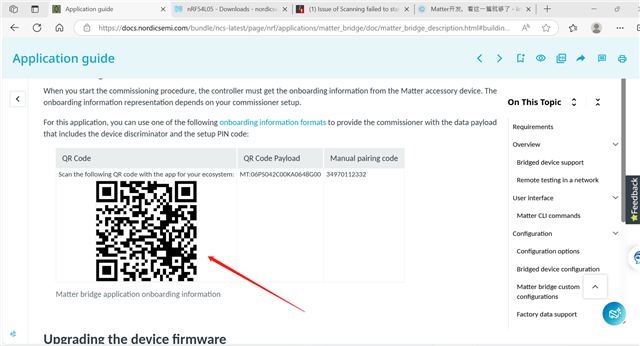

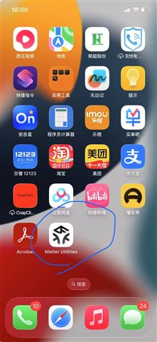

I try to use Matter Utilities app to scan the QR Code for commissioning the matter bridge, but it commission failed. The attached file is the log of matter bridge. Could you help analyze the issue. Many thanks.
We don't test the Matter Utilities app
Please refer to the Commissioning the device section to test.
