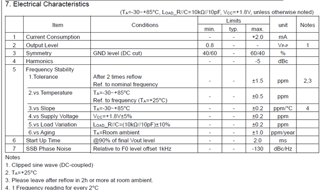

    3. Presumably PPS accuracy will be defined by the timing source (preferably TCXO).  But what is the TCXO accuracy?  I couldn't find a spec in the datasheet.
    We don't disclose or guarantee the frequency stability of TCXO because the part numbers for TCXO often change even during the lifetime of single product. But here is a typical data sheet from a TCXO we've used
    Assuming stable room temperature conditions, stable supply voltage etc. the frequency error of the TCXO is no greater than 1.5ppm. This corresponds to 1.5 us error per second of wall clock time. This equals to about 5ms per minute. Note that this is the worst case scenario where the frequency error is constantly at the maximum level permitted by the data sheet. Usually components behave better that this because a component not meeting the data sheet performance would be considered defective. So you can consider this number as a rough upper limit for the 1PPS error when GNSS is sleeping and TCXO cannot be disciplined from GNSS fixes.
    4. The Sleep Timing Source section notes that (as expected) leaving the TCXO on will impact current consumption.  But what would be the expected TCXO current consumption?  Would it be expected to be as high as Igps_continuous (43.1mA typical)?
    According to same datasheet the current consumption should be round 2mA @ 1.8V
