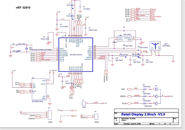

Hi Everyone,
We are developing a custom retail display solution based on the nRF52810 SoC.
Currently, we are facing an issue where BLE advertising does not start properly on our board.
We suspect that the antenna matching circuit might have a problem.
I am attaching our circuit diagram showing the antenna matching network, which includes:
  • C11 and C12 = 12 pF
  • L3 and L4 = 3.9 nH
  • C26 = 0.8 pF
The operating frequency is 2.45 GHz (BLE band) and the target input impedance is 50 Ω.
Could you please help review the antenna matching section and confirm if the design looks correct?
If there are any improvements or corrections you suggest, that would be extremely helpful.

    Has there been any measurements for the antenna or just calculations?
    I see that in one design you have a PCB antenna and the other a chip antenna.
    Can you  provide the datasheet for the chip antenna?

    We did not calculate and design the antenna ourselves; instead, we based the design on the dimensions of the antenna from another sample board.
    I have attached the datasheet of the chip antenna for your reference.
    That is perfectly fine, as long as the design is followed it should work ok, and with a few extra matching components it can be tuned if needed.
    For the 2450AT18A100 antenn it is important for follow the recommendations and looks like that has been done. It is possible to ask johansontechnology for help as well as they do have support.
    Values look ok\realistic but it is impossible to accurately give feedback on what component values are best without physically testing the device either conducted or radiated.
    So far all looks ok and is a good starting point but it is likely that the two versions need different values.
