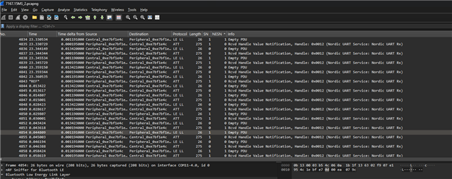

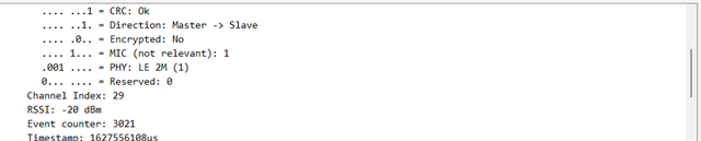

    We have already been using the 2MBPS PHY, and the screenshot from the nRF Sniffer can also serve as evidence. We have adjusted CONFIG_BT_BUF_ACL_TX_COUNT to 30, but the experimental results remain consistent with those before (no changes occurred). Could it be that this configuration is not being implemented? Do we need to add some code in the main function to make it take effect?
    In particular, regarding the connection interval: when we increase the connection interval, the number of data packets with the -12 error increases—which corresponds to the increased number of queued data packets you mentioned. The more we extend the interval, the more queued data packets there are, showing a proportional relationship. This has been a point that has confused us.
    Attached are all our configurations and the code for the main function, for your reference. 0020.prj.conf

    Interestingly, when my timer K_MSEC() is set to 4 and the connection interval is set to 7.5ms, data packets do not queue (-12), but the rate is 3.8ms, which does not meet our target of 3ms. When K_MSEC() is set to 4 and the connection interval is 15ms, data packets start to queue (approximately 2 out of every 5 packets are queued). When K_MSEC() is set to 3 and the connection interval is 7.5ms, data packets also queue (roughly 1 out of every 3 packets is queued). If K_MSEC() is set to 3 and the connection interval is 15ms, even more data packets will queue.
    This seems very much like a blockage at the TX (transmit) end. Regrettably, however, adjusting the value of CONFIG_BT_BUF_ACL_TX_COUNT does not result in any observable changes.
  • Can you please zip and upload your peripheral and central application, so that I can have a look?
