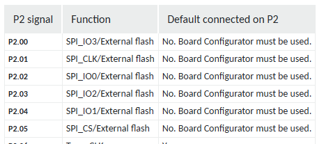

How to configure SPI pins on nRF54L15
I'm trying to connect an SPI device on the nRF54L15-DK kit. The Nordic support page says it needs to be configured using the board configurator, as seen in the screenshot below

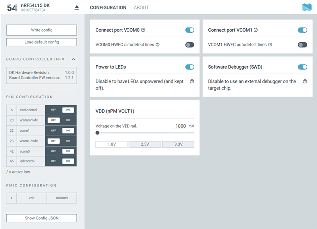

However, in the board configurator, I see no such option (its up to date as well)
Not sure if I'm missing something, but any assistance would be of great help.

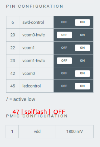

    The board configurator app has not been updated yet to support rerouting of the SPI lines, but it is possible to apply this configuration using nrfutil for now. The nrfutil command is:
    nrfutil device x-execute-batch --traits boardController --batch-path nrf54l15dk_reroute_spi_flash_pins.json
    And the json (I tried to match it to the configuration from your screenshot):
        "operations": [
                "operation":{
                    "type": "smp",
                    "operation":2,
                    "group_id":64,
                    "command_id":0,
                    "sequence_number":0,
                    "data": [[6, true, 9, true, 20, false, 22, true, 23, false, 42, true, 45, true, 47, false],[1,1800]]
                "operationId":"1"
    This sets pin 47 high which is the control signal for the SPI flash lines
    Vidar

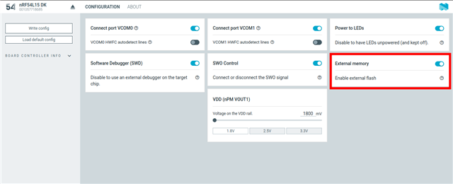

    Update:
    This configuration is now supported in the app as well:
