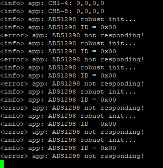

No data coming from ADS1298 after connecting the SPI with nRF52833.
Hi, I am working on a project where ECG data can be send wirelessly. For that I am using ADS1298 and nRF52833. I am very new to it. I have connected the nRF52833 SPI lines with the ADS1298. For power, since the DRDY was not falling when I used the power from nRF52833, I am using the MMB0 board by the ADS1298 ECG FE itself. Still I am not getting any output. I am not sure what I am not getting right. I can see the DRDY going low and coming back, the CS and SCLK are all working but there is no output from DOUT(MISO). What could be reasons? I saw some old queries about the issue and they are mentioning about the timing of CS. How to check that? I have also provided the code that I am using.

    uint8_t id = ads_read_reg(0x00);
    NRF_LOG_INFO("ADS1298 ID = 0x%02X", id);
    NRF_LOG_FLUSH();
    // Choose mode here: true = internal test signal; false = ECG electrode mode
    bool test_mode = true; // <-- change as needed
    if ((id & 0xF0) == 0x90 || id != 0x00) {
        NRF_LOG_INFO("ADS seems present, configuring...");
        ads_init_sequence(test_mode);
    } else {
        NRF_LOG_ERROR("ADS not responding. Check power, PWDN, CLKSEL, reset, wiring.");
