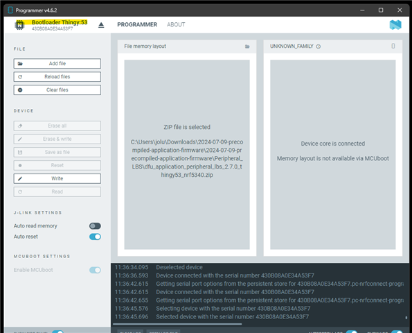

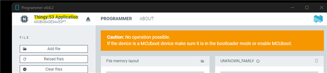

nRF Connect Programmer Failure
Issue: nRF Connect for Desktop Programmer app produced error -1073741819 when attempting to write firmware Error location: MCUboot DFU window after pressing "Write" Resolution: Switched to command-line nrfutil tool

Parents Reply
  • Can you share a screenshot?
    It seems from my understanding that the device works if you reset it but you are not able to program. But it shows up on the computer and is detected by the programmer application?
    To me this sounds like the device is\was working out of the box, but you are not able to test other applications on it?
    Try different USB cables and also have the Thingy connected to the computer and at the same time also make sure the device is powered on with the power switch.
