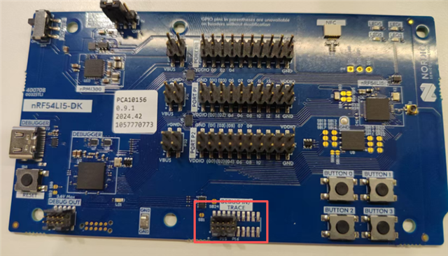

hi support team,
customer told me 54L15dk debug out is not able to program another 54L15 chip.
so i tried,
1. A-54L15dk debug out program B-54L15dk debug in, failed.
2. B-54L15dk debug out program A-54L15dk debug in, failed.
3. 7002dk debug out program 54l15dk debug in, failed.
4. 54L15dk debug out program 7002dk debug in, OK.
from customer side, they want to using 54l15dk to program their products, i coud't find the problem, please help.
thanks in advance.
William.

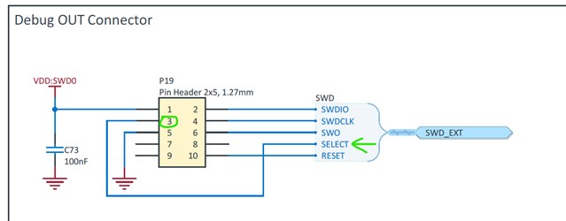

Parents Reply
  • Longer cables may not work reliably. There have been issues reported related to longer cables for programming. Short cables help to maintain signal integrity. You should be able to use longer cables as long as you have full control on signal along the cable. You might need to use decupling capacitors on each wire to filter out unwanted interference/couplings.
